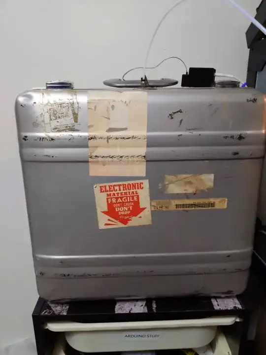

I have recently, in anticipation of printing carbon-fiber-reinforced nylon filament (Polymaker PA6-CF) on my Prusa i3 MK3S, built a filament drybox. It is made out of a large aluminum equipment enclosure which I had spare, every seam, rivet, hinge mount, foot screw, sealing lip, etc of which has been sealed with copious amounts of high-quality silicone sealant (this is condensation-curing silicone, so it does release a small amount of moisture as it cures, but it has been in here several days and is about as cured as it gets now). The lip around the edge of is clamped hard against a rubber sealing ring, which I have cleaned meticulously, when the lid of the box is closed and latched. In short, it is, by 3D printer drybox standards, unusually well-sealed.

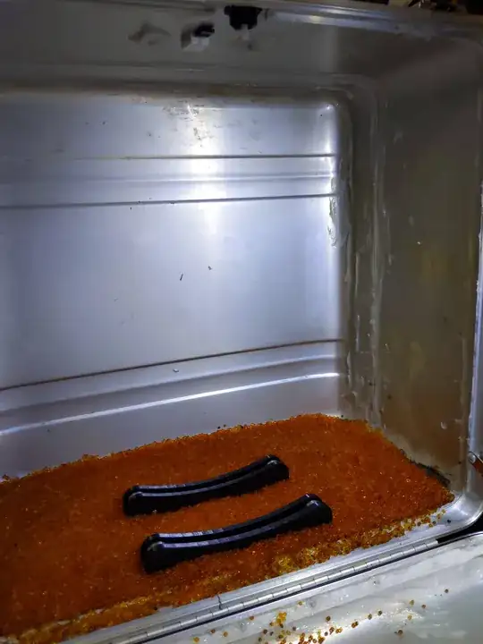

The exterior of the box Inside (yes, I know my silicone work is a mess, but let nobody say I missed a spot!)
For drying, I have poured two pounds of orange self-indicating silica gel, freshly regenerated, directly into the bottom of the box, exposing the maximum possible surface area (as opposed to having it in a container).
