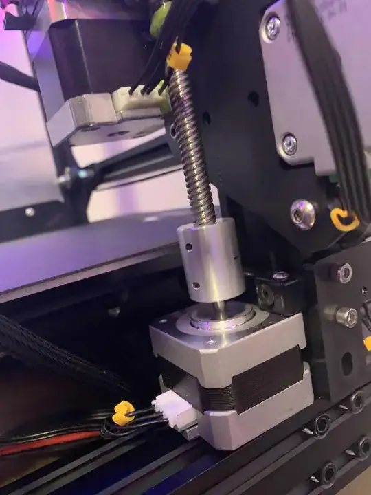

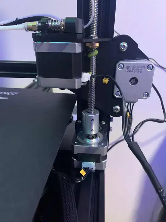

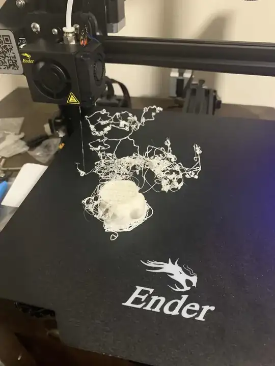

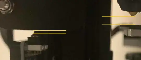

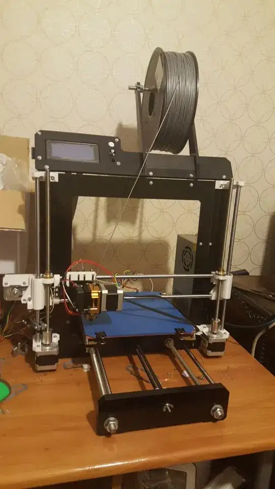

So I just got my first 3D printer the Ender 3 Pro. My nozzle is a bit too high (first image) and this is what happened after my first test print (second image).
I saved for a while to buy this and I’m really upset about this.
Photo of Ender 3 Pro nozzle well above the build plate

  • Have you checked to make sure that the Z endstop is properly positioned according to the assembly instructions? – agarza Feb 26 '22 at 02:56
  • I’m pretty sure it’s in correctly. I added 2 pictures of it to the post (should I remove the green oil or whatever it is?) – desperrrr Feb 26 '22 at 03:03
    The Z endstop (or limit switch) is in your first photo on the left-hand side. It is attached to the outside of the vertical rail. If that is not set properly the nozzle will be too high off the bed. – agarza Feb 26 '22 at 04:00
  • Sorry for the dumb questions but how do you mean “properly”? – desperrrr Feb 26 '22 at 04:50
  • The Z endstop should be positioned so that when the nozzle is just touching the build plate the limit switch is triggered. It may take a bit to align correctly. Also make sure that the Z endstop does not rotate when you tighten the screws; this can effect the nozzle height. – agarza Feb 26 '22 at 05:07
  • Hi, welcome to 3DPrinting.SE! Don't be upset, it is s minor issue that is easily fixed! Note, the title "Nozzle too far from bed, prints fail" might be a better description of your problem?.The current title hints to an unlevel/untrammed bed, while the issue is an overall offset. You can [edit] your question! Read my answer below and the link to the article, you should be up and running in a jiffy! – 0scar Feb 26 '22 at 07:59
  • Hi. I followed what you said in your answer and the article but it’s still too high. Read my comments on the answer for more detail – desperrrr Feb 26 '22 at 18:06
  • unrelated to your problem, but you might want to remove the excess grease from the screw. – Trish Feb 26 '22 at 20:26
Your Z-endstop assembly is clearly too high. Referring to your own first foto you see that the switch on the Z-endstop mount is nearly touching the bottom of the X-Z mounting.

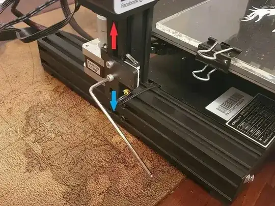

You need to adjust the whole mount by loosening the 2 hex key screws and lower the assembly (move in the direction of the blue arrow):
enter image description here Source: Larry Wood via All3DP
Before lowering the Z-endstop mount first screw in all the levelling/tramming screws under the build plate/heated bef a little and position the nozzle a little above the build plate; when the mount is fastened you can move the build plate up a little and tram the complete bed surface.
This All3D article describes the above in more detail, but the basics are covered above.

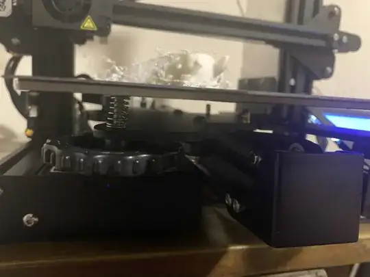

  • I did all this and when I auto home, the Z still stops well above the print bed like a whole 5 mm. I even tried manually adjusting the Z-axis and setting home and then auto home but it still stops high above the bed. I also try raising the bed but the knobs become so loose they fall off. – desperrrr Feb 26 '22 at 17:28
  • @desperrrr Then you are maybe mistakingly doing something wrong? This is the way to get the nozzle to the build plate level. Maybe you can edit your question with more specifics, e.g. describe in steps what you do, and add a photo where Z=0. Note that after homing the nozzle is always raised, so be sure to guide it to Z=0. – 0scar Feb 26 '22 at 23:56
