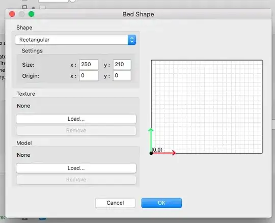

Octoprint is printing in the top right corner of my Prusa Mini. What is causing this and how can I fix it?
linuxdan
  • 1,289
  • 27
I had the wrong dimensions set in PrusaSlicer, under Bed Shape:
Screenshot of the Bed Shape window in PrusaSlicer showing previous settings

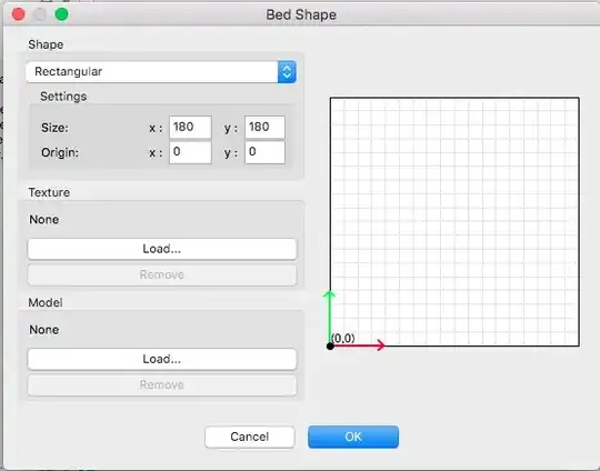

I needed to change X and Y to 180:

  • Indeed a slicer error, not a print server error. OctoPrint Just prints where you have sliced it. – 0scar Jan 30 '22 at 22:28
