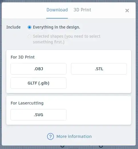

When I export a model from www.TinkerCad.com I get these options: .obj, .stl, .glb. enter image description here
No matter which I choose for export, if I reimport what I exported, it is now one solid piece and it appears I cannot ungroup its elements to edit them anymore.
