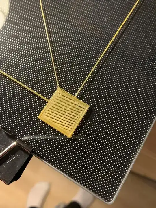

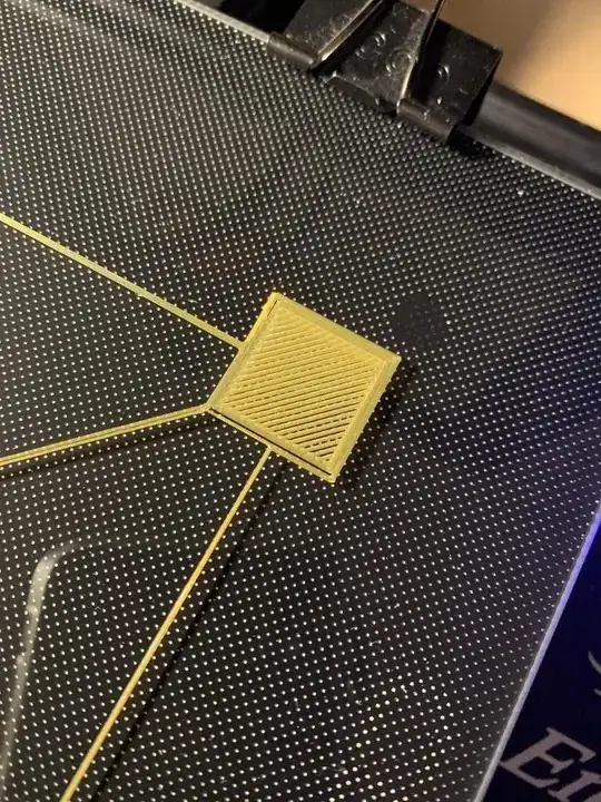

I have an Ender 3 V1 with a glass Creality plate. I was having difficulty using manual levelling and my prints were struggling, so I ordered a 3DTouch. I have installed the 3DTouch and used Creality's BLTouch firmware. But my bed is still not level.
So my build is an Ender 3 V1 with:
  • Extruder upgraded to all-metal extruder
  • Glass bed upgrade
  • 3DTouch Upgrade
  • Capricorn Tubing
  • Yellow bed springs
I manually levelled my bed using my 3DTouch. I used the G30 command in Pronterface to probe each corner of the plate. At each corner, I would adjust the knob until the 3DTouch read 0.0. I did this iteratively multiple times until I thought it was reasonably level. The four corner values were something like 0.1, 0.0, -0.2, and 0.3 mm.
I have also put a straight edge with an Angle Finder Phone App. The bed is quite level. It reads 0, 1, or 2° depending on how I place the level. X-axis gantry has a 1° tilt.

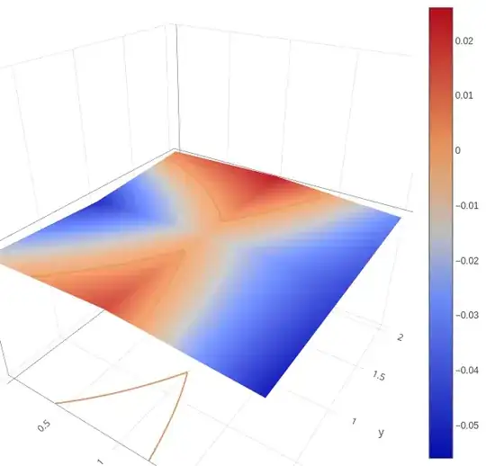

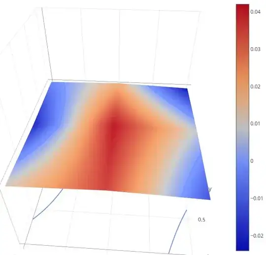

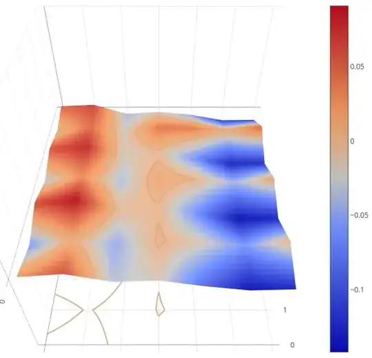

Here is my current bed levelling mesh:
My mesh bed levelling result

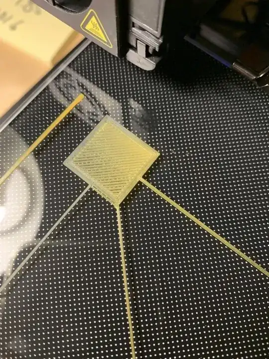

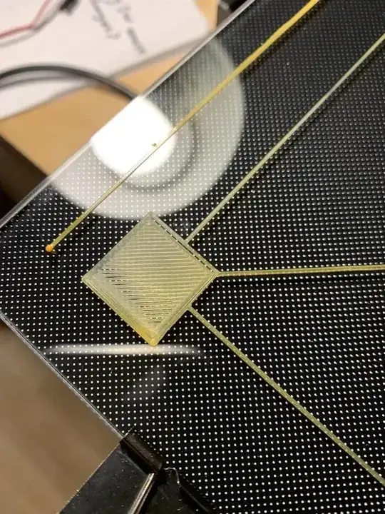

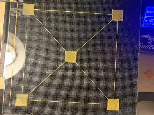

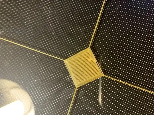

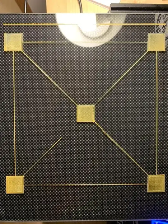

After doing this, I added G29 after G28 in my starting G-Code in Cura. I sliced a model from Thingiverse that had 5 squares and some lines. Here are the results:
I am using:
  • Filament : PLA
  • Bed Temp : 60 °C
  • Nozzle Temp : 200 °C
Some miscellaneous notes:
  • The bed was cleaned thoroughly prior to use
  • I rotated the bed 90° and the print looked the exact same way
  • I ensured that the bed soaked in some heat for some time prior to printing
  • I have set my Z offset to -1.800 mm
  • The frame and components seem to be square and tightened down. Nothing is shaking around and seems to be in order.
I would really appreciate help on this. I'm really not sure what to do next. I've been really excited about 3D printing and I hope I can find a solution to this.

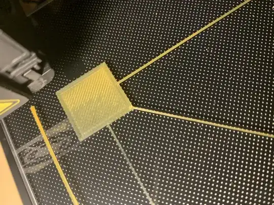

Leveling using CHEP's video
So I have rebuilt my 3D printer using CHEP's video. I noticed that one or two things were off compared to how it was supposed to be. I will be doing some test prints to see if that actually fixed things. I am hopeful.

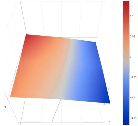

I did a mesh before any other changes, and the slant is very clear now. See below. I believe one of the plates on the gantry wasn't completely straight.
Leveling after rebuilding printer
Here is my latest mesh, after rebuilding the printer and then re-levelling its bed manually.

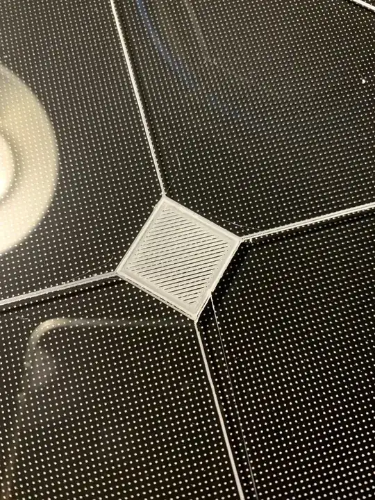

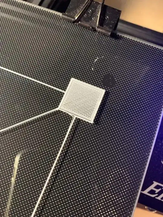

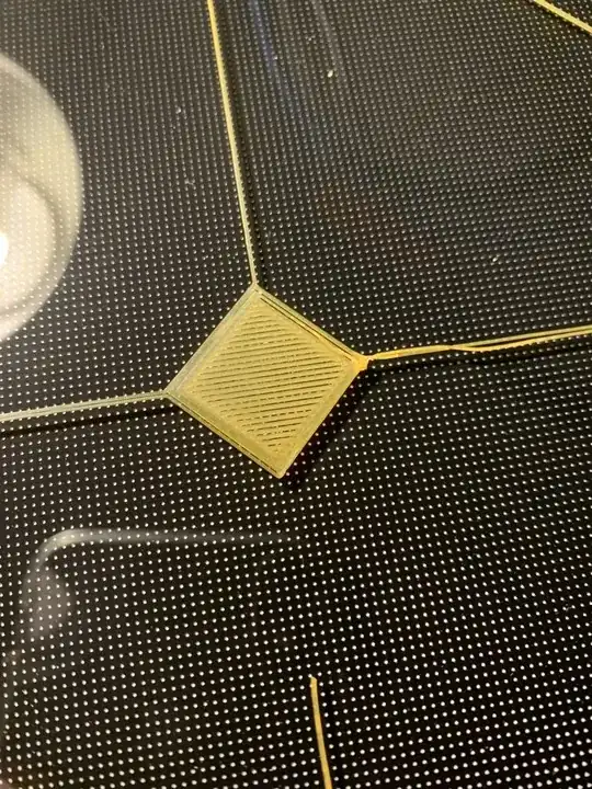

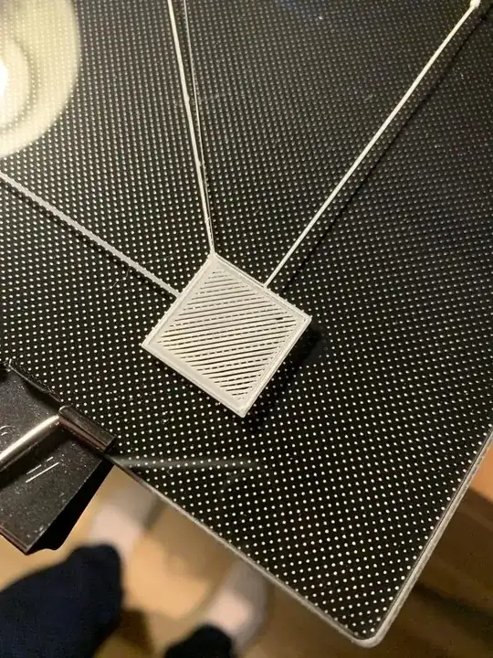

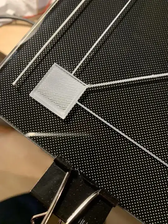

These are the results of the print. I had to change my Z offset to -1.60 mm. The broken line is my fault. It was caused by my finger. The focus is the corners. As I mentioned, this is after rebuilding my printer.
Edit

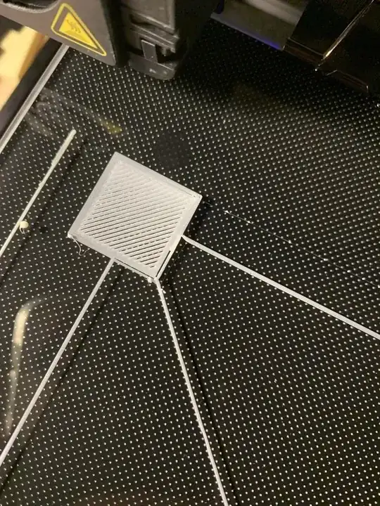

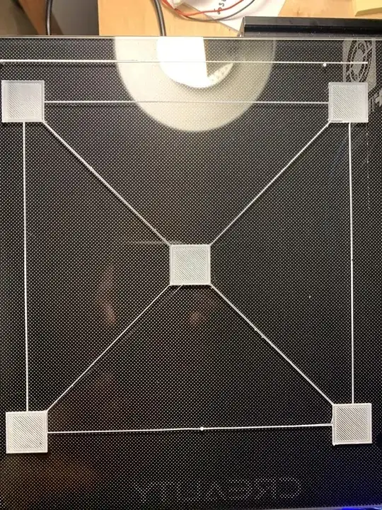

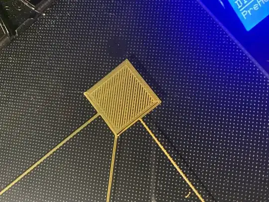

The following prints are the result.
The mesh before this print is as follows:
Levelling the X-Axis Gantry
As Oscar in the comments has mentioned, I have read some other forum posts that described the cause of uneven lines and similar inconsistencies as what I am noticing, as being due to the X-axis Gantry that moves up and down as not being level.
I used a digital caliper and measured the x axis gantry relative to the frame of the 3D printer. So for example, I put my caliper against the base metal extrusion and then against the x-axis gantry. I did this on both sides.
The side without the Z-Axis lead screw (right side) was above the side with the Z-Axis lead screw (left side) by about 1.7mm. I'm surprised that CHEP and some other build videos never mentioned to check this, but it does seem logical to consider. Making the brackets flush is NOT adequate. When I do make it flush, then one side is higher than the other. The build videos say to make it flush. This will make things OFF.
To adjust this, I took off the gantry, slightly loosened the bolts on both side plates, so that it was stiff enough that it wouldn't move easily, but could make subtle adjustments by twisting it hard enough. I then put the gantry back on the printer, did some measurements and corresponding adjustments. I then carefully threaded the gantry off and tightened the plates.
Currently, my left and right side have a difference of .17mm. I figured I won't get anything better by hand. I'll do another test print tonight. 1.7mm vs .17mm is a reasonable difference.

One red flag:
"Level" in the sense of bed leveling does not have anything to do with being level relative to the earth's gravity. If your X axis is tilted but your bed isn't, there's your problem. They have to be square to each other, not level with respect to any external reference (you can operate your printer on its side or upside down for all it cares).
If you find that, no matter how much you try to tune the bed leveling, it keeps coming out different by the time you print, you probably don't have a problem with your bed but with the X axis gantry and Z motion system it's attached to. If the frame the Z carriages run up and down is not entirely square, or if the wheel tension is not right, the undriven side might not follow correctly with the driven side. This means sometimes positioning at the right (viewed from front) side of the printer will come out too high, and other times too low, depending on a lot of factors, the most obvious one being last direction of Z travel.
  • Thank you. I really appreciate your response. I wanted to mention that I understand that level measurements are not significant. But I thought it was interesting enough to post about. My bed levelling was done on the basis of distance from the nozzle, and the level was just an observation and did not influence levelling. Thanks. I will try to further investigate the x-axis gantry that is moving up and down. The tilt on that was 1 degree, downwards towards the side with no z-axis. However, I found the bed to also have a tile of 1 degree to that side. – geekgeek4 Dec 18 '21 at 23:27
You need to check the X gantry, the Ender design is flawed by using a single Z screw on one side. Please check the rollers and check the belt tension. All the leveling graphs show that the bed is lower on the right side (or the gantry higher), it could be that the rollers on the right post (when facing the printer) are causing the right side to be lower.
  • Question for you. Do you think there is a problem with using G30 to level a bed? I noticed that even when I use my G30 approach, I seem to still end up with a slanted bed. Is there some flaw to the G30 approach? I tried searching for it online, but I pretty much found nothing about using G30 to manually adjust the knobs. But I thought it would be far more scientific and precise than the paper method. – geekgeek4 Dec 21 '21 at 03:27
  • Even with a 3DTouch, bed leveling needs to be done manually, I never use `G30` or have used the past 6 years, instead I do a `G28`, lower the head to paper thickness between nozzle and bed, than de-power the steppers and manually tram the bed everywhere (corners and middle of the bed) so that it is as level as possible (note to use `G28`, move to a corner, move down and de-power multiple times). This ensures that the bed is in the same plane as the nozzle, unless the bed is really skew/bent this should work. When done you only have to set the correct Z offset and add `G29` to the start G-code. – 0scar Dec 21 '21 at 09:14
  • @geekgeek4 The problem you are facing is not the `G30` or manual leveling procedure, but most logically a mechanical issue. I'm not here to speak evil of the Ender design because it can work well when properly set up and tuned, but the design can lead to frustrations for new users when it does not perform up to par. P.S. note that comments are not here to last forever, you might see them disappear after a while when comments are addressed in the Q and A's. :-) – 0scar Dec 21 '21 at 09:18
