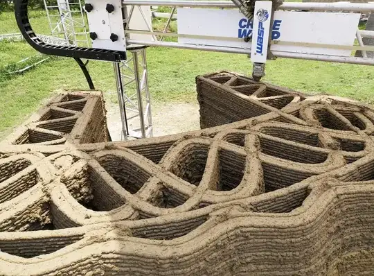

On a large scale, there are "3d printers" that can place a special quick-drying concrete and produce small buildings as homes in a matter of days. However they're fed a special mixture of smooth cement and accelerators to set the concrete ready for the next layer.
Tecla 3d printed house
