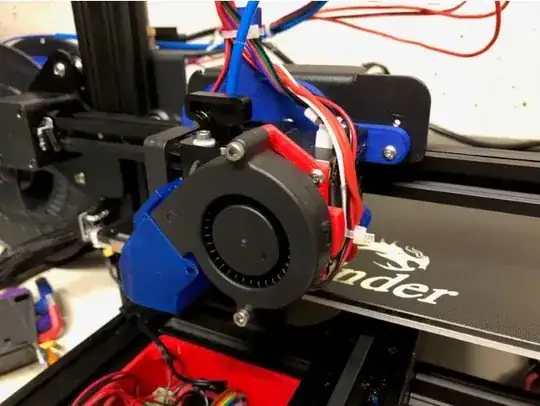

A specific mount for the Ender 3 is found here.
