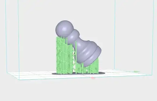

I'm trying to slice some models using the default HALOT BOX software from Creality, which comes with the Halot One resin 3D printer.
I've oriented them at 45 degrees, and am using supports. When I come to slice the models, the models all jump up a few millimetres, as seen in the below screenshot.

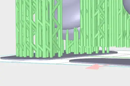

I thought it was just a UI bug, until the same image also appears on the printer screen, with a gap between the supports and the raft.

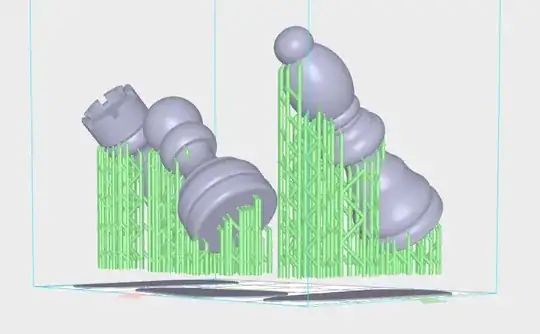

If I reset the position of the model, it goes back down as I would expect it to be, but when I click "slice" it moves back up again.
One object back in place

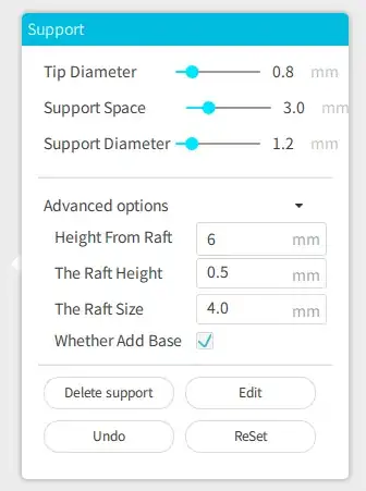

My settings are as follows:
Slicer settings
How do I fix this?

  • height from Raft – Trish Oct 19 '21 at 14:02
  • @Trish Just tried messing around with that, and it appears that defines how far up the model is moved before the supports are created. You can see in [this image](https://i.stack.imgur.com/Z2t7j.png) that it's touching the bottom, and the "Generate support" button is actually disabled (hard to see, but it is). When put it back to 6mm, it can generate supports and [looks like this](https://i.stack.imgur.com/6JL8q.png) before trying to slice (after which it jumps up again as per the question). – user-596a6526 Oct 20 '21 at 06:22
  • Have you tried "height from Raft 0.2" for a very tiny gap? – Trish Oct 20 '21 at 06:44
  • @Trish the lowest it lets me go is 2mm. I tried that, but it still jumps up, so I tried setting the raft height higher but it still jumps up beyond that as well. Maybe I need to file a bug report with the developers, but it's a bit annoying I can only use the HALOT BOX software and not something of my choice :( – user-596a6526 Oct 20 '21 at 08:07
