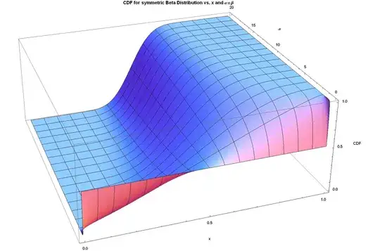

Suppose I have the X, Y, and Z coordinates (either in a list or a function z = f(x,y)) that defines a shape as the one provided and I want to 3D print it with a solid bottom, is there an easy way to do this? If not, how can a functionally well-defined shape be put into a 3D modeling software like FreeCAD?
3D graph

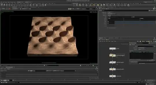

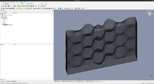

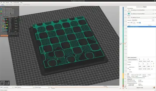

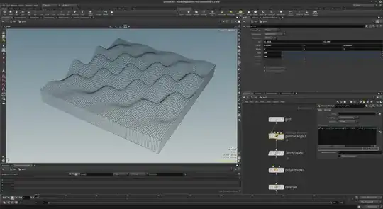

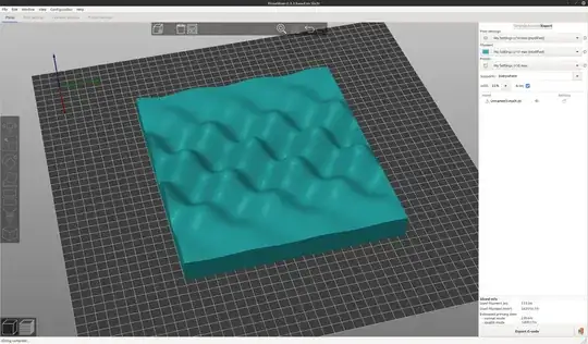

Not sure what you're asking exactly, but you can use this workflow:
  1. SideFX Houdini: math function + STL file generation enter image description here enter image description here
  2. (optional) FreeCAD: Import STL as mesh, do whatever you need to do in FreeCAD, export to STL enter image description here
  3. a slicer: import the STL and slice it. enter image description here enter image description here
