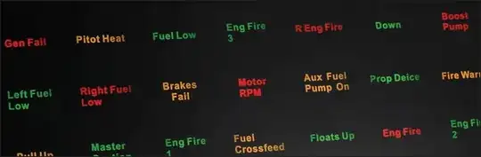

Using 3D printing I'd like to create a text oversized keycap that uses several strong LEDs to make the text light as red or green, depending on status. It's quite similar to what are called annunciators on aircraft:
Annunciator Panel example without the panels being turned into MX switch keycaps
Annunciator removed from a panel where it is separated
I'd like to create an MX keycap with this ability and size with the backlighting changing from green to red to indicate something is on or off. I understand including the MX connector in the center, but how would I print a black panel and leave the text transparent, or at least transluscent?
