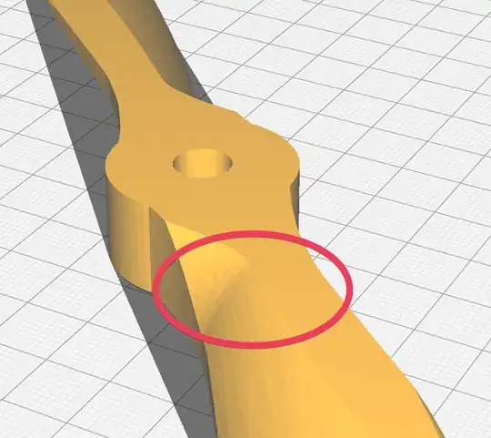

The design of the propeller is actually sacrificing some aerodynamic efficiency in order to make sure there are no "thin" parts. It is typically breaking in the section I have highlighted in the the following picture.
3D rendering of a propeller with a circle around a section

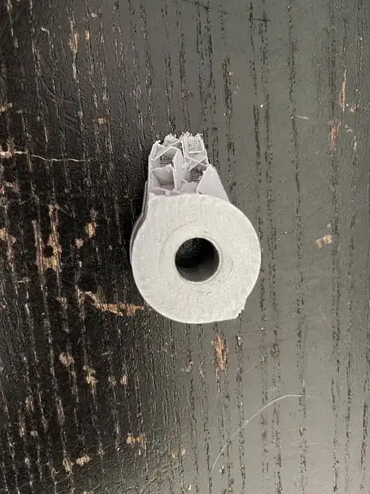

I have also a picture of the "remains" of the broken PLA propeller. It actually held up many runs before it eventually broke. It actually partially delaminated the entire wall.
A damaged print of a propeller

As Kezat noted, your part has very low infill, but infill is not what provides most of the part strength anyway. From what I can see of the broken part, it looks like you only have 1 or at most 2 walls, and these are what contribute most to part strength, especially in the orientation you're working in.
You should probably increase the number of walls to the point where the part is entirely solid, and has no infill region in any layers. This gives much better strength than selecting "100% infill", which will normally use alternating diagonal lines to fill the region; even if "concentric" is selected, which "looks like" more walls, there are subtle reasons it's not quite as good.
You may be able to get away with fewer walls, possibly just 3 or 4. If you're trying to keep total mass low, that might be worth trying first. But you definitely need more than the 1 or 2 you have now.
    I used an almost 100% walls (not infill) print for my next iteration. The image looks like its only 1-2 walls, however at least 2 walls had completely delaminated during destruction of the propeller, it was printed with 4 walls. – Yanick Salzmann Aug 15 '21 at 17:44
    If they delaminated, you should check for underextrusion - either globally, or due to oozing (e.g. from combed travel over the infill region) prior to the wall extrusions. – R.. GitHub STOP HELPING ICE Aug 15 '21 at 17:56
    A completely solid propeller would be counterproductive: the material near the tips is providing no strength, but is increasing the load near the hub. If your slicer permits it, increase the wall count just near the point of failure (ideally, tapering off as you go outwards, until the ends of the propeller have just one wall). – Mark Aug 15 '21 at 23:16
  • @Mark good point, I will play around a bit, I should be able to use various profiles for different parts of the object – Yanick Salzmann Aug 16 '21 at 07:16
