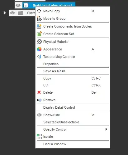

Not sure if this will solve your issue directly for you but when I save a STL/3MF from F360 I don't use the File/Export in 360.
Instead I just right click the body in the browser tree and save the STL/3MF directly from that menu. Select "save as mesh" This does not add any version number, and also the usage of cloud processing is not required so it's much faster.

    Yes, thanks, that solves my problem. Not the way you think, but it solves my problem. I noticed this basically gives me the same window I get when I send the model directly to a slicer over the tools tab. The difference is, the checkbox to send it to a slicer isn't checked by default and a file gets created instead. Before, I didn't even realize this checkbox is there. The way you describe also solves another problem. I can export multiple bodies as separate STL files. That will help me as soon as I start using the dual extrusion feature of the printer I just bought. – JuSchu Aug 10 '21 at 21:52
