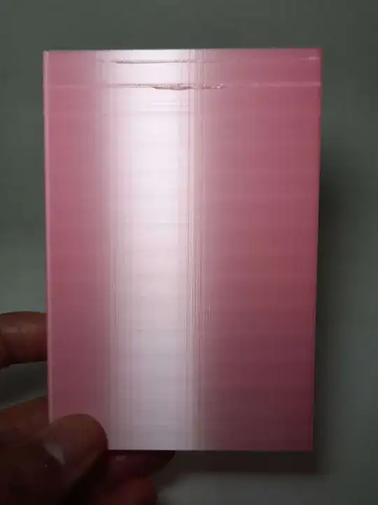

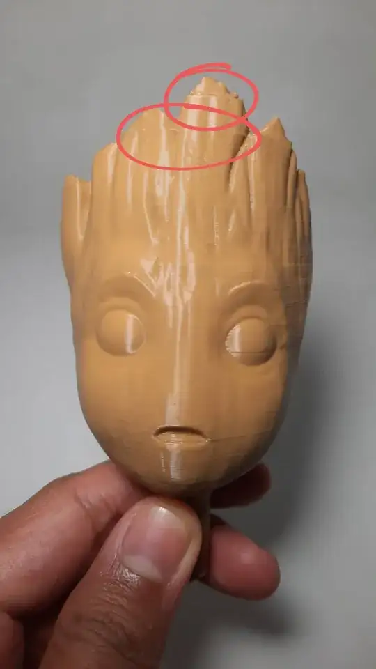

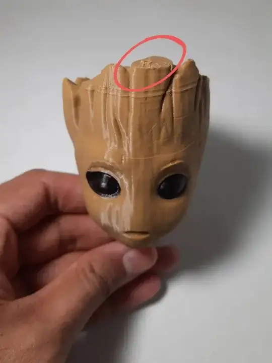

I have tried to print Baby Groot , but every time I print the head, there are always layer shifts like the photos below. I have printed three heads and the layer shifts happened all in the same place.

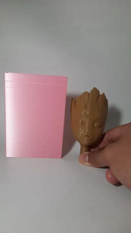

I tried to print something else that is the (more or less) same height and the layer shifting also happened.
I was thinking maybe because z-rod bent. But apparently the layer shift happened in different height.
What is my problem and how to solve this ? I am using Ender 3 with BLTouch.

In your case, you appear to have temporary shifts. Those on the Groot head seem (in the photos) to line up with heights at which some of the peaks on the head end; they might be a result of changes in the nozzle interaction with a print that's becoming tall enough to flex as the path changes due to those sections finishing. The ones on the pink block look more like temporary overextrusion, but since we can't see the opposite side of whatever that is, I can't say for certain that they aren't the same thing.
One thing you might try is reslicing both of those objects with Z-hop enabled. That will reduce nozzle dragging over earlier parts of the current layer, which can flex the part (or temporarily block the nozzle, causing pressure buildup that will lead to momentary overextrusion).
To save time, you might look for whether you have any objects that exhibit this without as many hours of printing time (and tens of grams of filament) already spent -- perhaps you can sink Groot into the virtual bed in your slicer, so as to print him only from the eyes up (or even higher) -- though that might reduce flex enough that finishing the peaks on his head won't result in a significant change.

  • I always use 0.4 mm z-lift (z-hop in PrusaSlicer). And the pink block has the opposite side more or less the same. Is this more into a bent z-rod or a wobble bed? I feel you are more inclined toward wobble y-axis than z-axis. – notalentgeek Jul 15 '21 at 16:08
  • For a screw-fed Z axis, that has correctly adjusted gantry rollers, the Z screw won't do much of anything to the Y axis position. This has to be the bed being out of position. – Zeiss Ikon Jul 15 '21 at 16:28
  • Hey there, I have tried to tighten the bed to no wobble. Using this video https://www.youtube.com/watch?v=liJ0DbuMeZ4 as a guide. But the problem is still persist. – notalentgeek Jul 16 '21 at 16:16
  • That puts us back to nozzle/print interaction. – Zeiss Ikon Jul 16 '21 at 16:23
  • Hey there... I just found out in case of the pink vase, it is happened due to the nozzle dragging the the shell/perimeter! My question become, why is it happening on specific height consistently? – notalentgeek Jul 16 '21 at 16:29
  • I'm going to guess that print doesn't have the Z-lift, and the nozzle drag happens when the nozzle runs back over already printed material from the same layer; it happens at the same height because that's the height at which the combination of Y-axis acceleration and print flex put the part in the way. There'll be a change in bed acceleration on Groot when each peak finishes, too -- which might be why you have the artifacts at those heights. – Zeiss Ikon Jul 16 '21 at 16:32

However, I do see some other layer issues on the head further down the print. I would probably loosen and readjust all the gantries again, check all the belt tensions, do another bed level (you changed out the stock springs with the yellow ones right?). After hours of use, not uncommon for there to be a hiccup, maybe a piece of plastic / dust stuck in a track.
