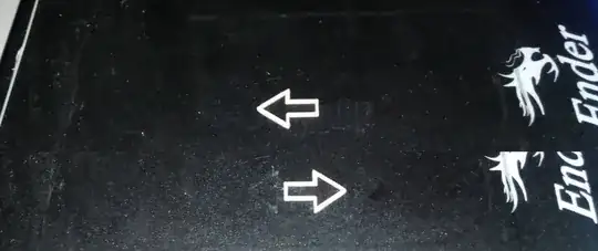

Based on @John Mecham's comprehensive answer, I whipped up a quick proof of concept. In the image below, the left arrow (top) is the original and the right arrow (bottom) is the reversed clone. Cura does generate a little relative offset code at the end, I think I handled it correctly.
Left and right arrows
