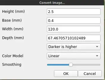

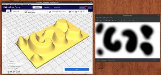

Cura will import a picture and use it as a heightmap to build a 3d object.enter image description here
There are a few options available when importing :enter image description here

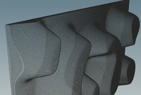

You can even export back the data as STL if you need to process the mesh. Here is the mesh exported in STL, opened in SideFX Houdini: enter image description here
