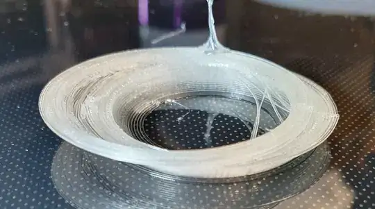

When the print head is jerking back and forth to fill in this area it causes horrible vibrations and really bad Y layer shift. You can see the vibrations transferred through the flexible neck of the black LED light in the foreground.

This is happening now on other parts that do not have particularly high jerk paths, it is shifting the Y by a full mm or more at a time.

Here is the part in the video; I of course stopped the print after it started shifting:

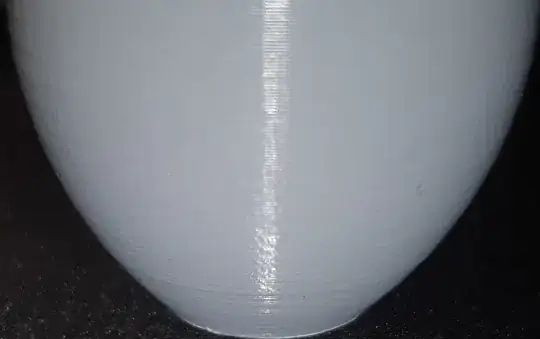

And this is how it is supposed to look:

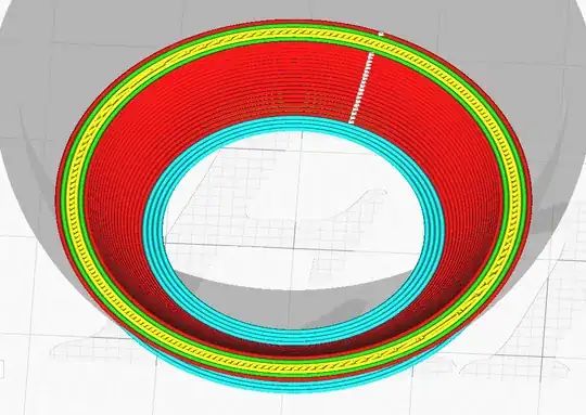

Here is the path that causes the problem:

  • I added a jpg to the OP of the sliced path of the layer around where the vibration started previously. As you can see that yellow center is what caused the head to change direction so rapidly. I'm not sure if this happened because of something new that is going wrong with the printer, or if it happened simply because this is the first time I have ever tried to print something with such a path. I only know that this same part printed fine on my ender 5 with default settings. Of course the ender 5 also has a much more voluminous mainboard enclosure and better cooling. – benram14159 May 05 '21 at 00:57
