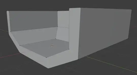

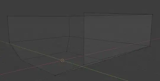

Next, we thicken that surface using the modifier menu: Select the Solidify modifier and set a thickness that looks good to you and that might be printable. Then make sure it pushes away from where your face is. Also make sure the Offset is at 1 or -1 to ensure that it does not stick out from the face-scan surface to the back! enter image description here

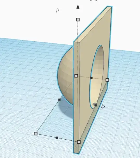

It depends on the software you're using, but here is an example with TinkerCad.

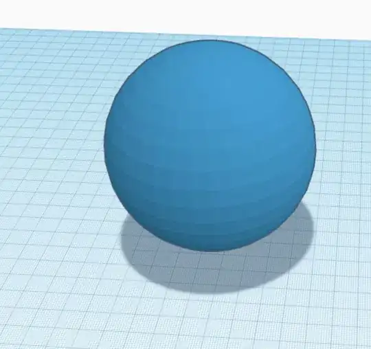

Step 1: Import your 3D model (imagine that the ball is a head):

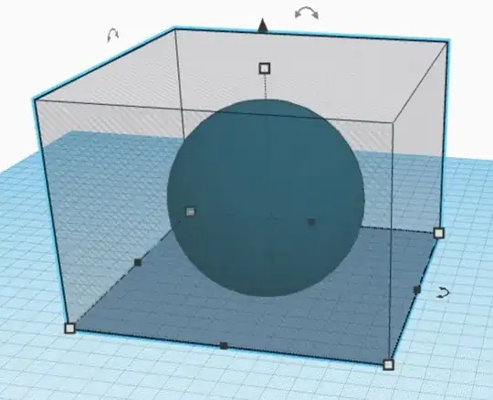

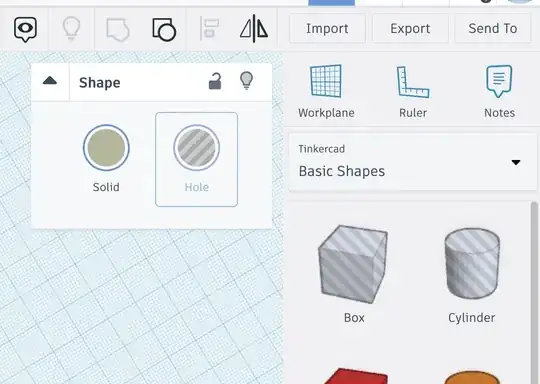

Step 2: Change its type from "Solid" to "Hole" enter image description here
Step 3: Create a "Solid" box around your imported model.

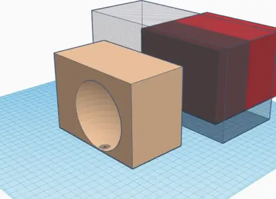

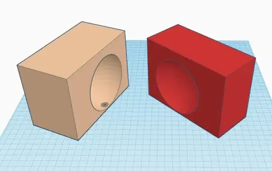

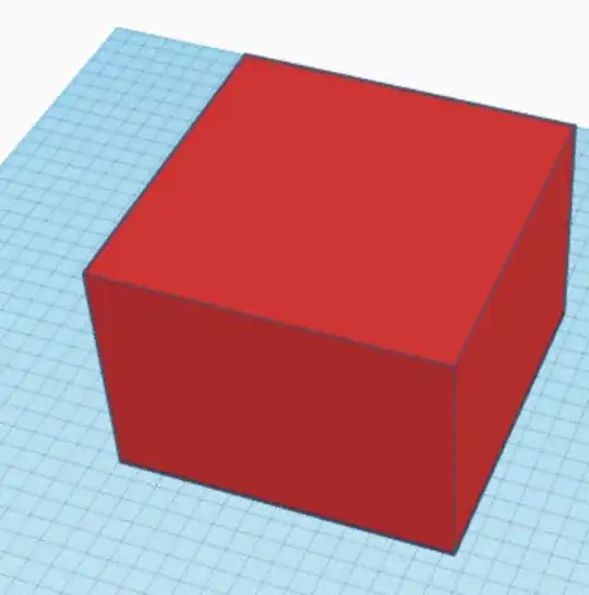

Here is the inverted Solid/Hole version: enter image description here
Here is the Solid version with the Hole model inside your Solid box: enter image description here
Step 4: Select both models and group them: enter image description here

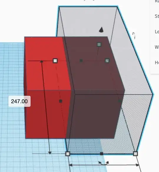

Step 5: Add a box covering half of your mold (ideally splitting it in half):

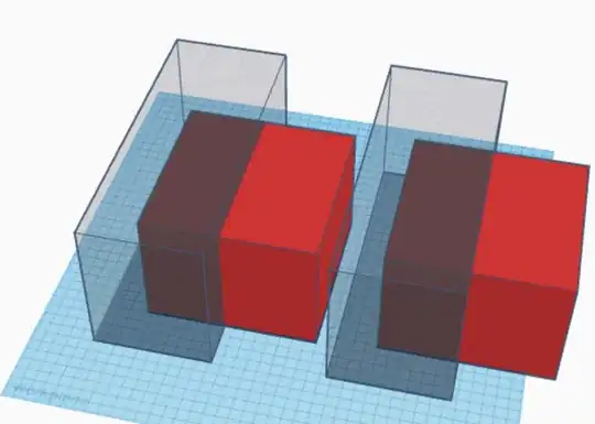

Step 6: Duplicate the mold and the box enter image description here

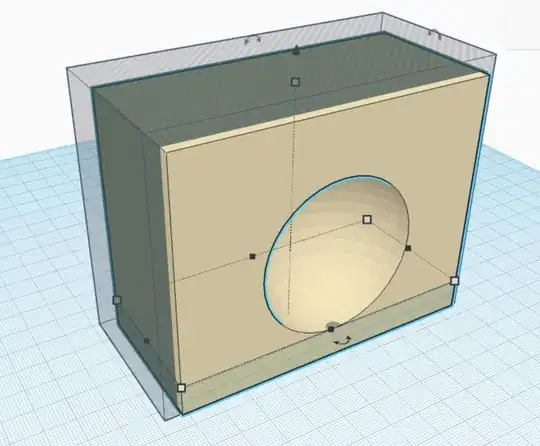

Step 7: Group the left mold with its surrounding box: enter image description here

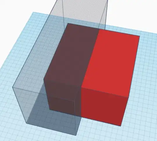

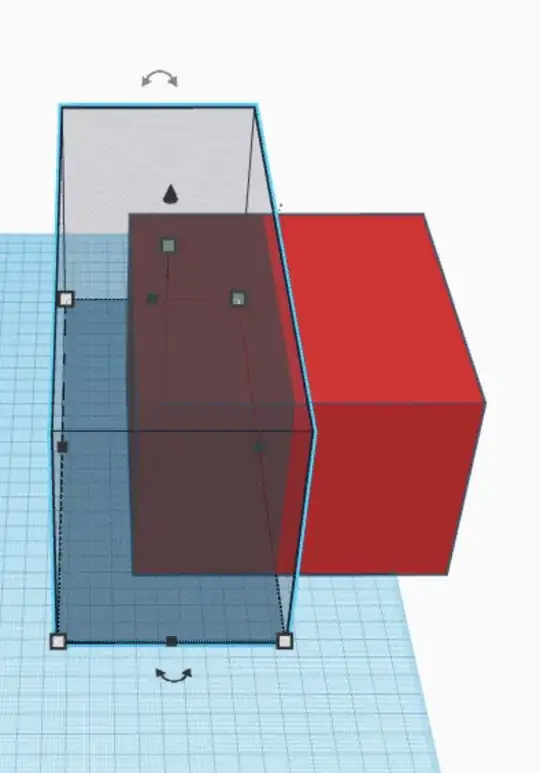

Step 8: Invert the box of the left mold by taking its left corner and dragging it over to the right side of the mold: enter image description here enter image description here
Step 9: Group the right box and the mold.
Step 10: You now have two molds for each half of your model: enter image description here
