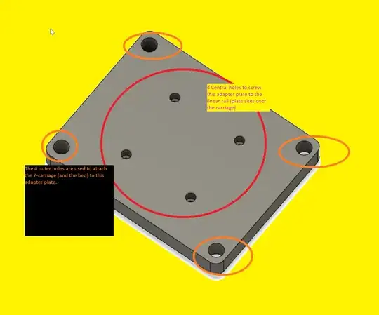

I have purchased a replacement bed for my 3D printer. I wish to have it mounted on a single linear rail.
Currently I am unable to drill properly into aluminum (due to problems with my drill).
Therefore, I'd like to print and use an adapter piece/plate to fasten the Y-carriage to the linear rail block. The bed has a thermal insulation foam so the area around the bottom of the Y-carriage plate/bed assembly doesn't seem to go over 60 °C.
My question is:
  • Which material should I use for this adapter piece, and why? (I have access to PLA, PETG and ABS.)
  • Should I use threaded inserts or fasten the Y-carriage with nuts?
Please see the image below to have an idea as to what I mean by an adapter.

    Borrow a drill from someone else. Printing a mounting plate like that would be a terrible idea due to the limited stiffness of plastic, especially at above ambient temperatures. – Ezra Mar 20 '21 at 20:59
Any thermoplastic is a bad choice to carry a heated bed. For an unheated bed, monolithic (cast, not printed) acrylic plate of sufficient thickness can be used.
To get the needed stiffness and temperature resistance, steel plate of about 2+mm is the best choice, followed by aluminium of a higher thickness. The latter can be sawed with woodworking equipment, if done slowly.
