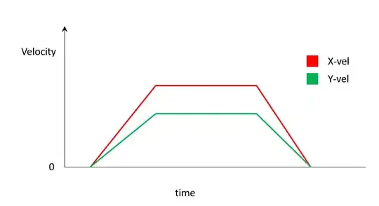

The stepper motors usually have a constant acceleration profile (trapezoidal profile) of an even jerk limit profile (S-curve profile). In linear motion, it seems possible to conserve proportion between x and y speed as shown enter image description here My confusion starts when the direction of motion changed so the proportion of speed must change too.
That impossible to join two velocity profiles except we decrease the speed of both axis down to zero then start ramping up with a new profile which means the 3D printer will stop and move for every G-Code segment that apparently not true. So my question is how does the firmware deal with these problems joining velocity profile?
