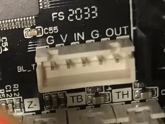

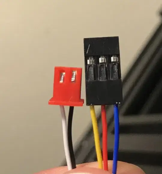

I'm using 3D4LYF's wiring scheme as I'm using the same set up I believe he is using. The two wires (white & black) on the red connector go in the Z-axis endstop port on the mainboard. For the three wires on the black connector I have: blue=Ground, red=V, yellow=IN that goes in the other 5 pin port on the mainboard. I rearranged the wiring from red/blue/yellow to blue/red/yellow as suggested by 3D4LYF again because I am using the BLTouch Creality Kit. Adding photos of 5-pin port and the connectors:

  • @0scar > BL Touch wiring used : Using 3D4LYF's wiring scheme as I'm using his same set up I believe : For the two wires (white & black) on the red connector that goes in the Z-axis end stop port on the mainboard. For the three wires on the black connector I have blue=Ground, red=V, yellow=IN that goes in the other 5 pin port on the mainboard. I rearranged the wiring from red/blue/yellow to blue/red/yellow as suggested by 3D4LYF again because I am using the BL Touch Creality Kit. Adding photos of wiring and 5-pin port above. – wallwalker Mar 07 '21 at 15:15
  • Photos here as well : https://imgur.com/a/uJAU0ne – wallwalker Mar 07 '21 at 15:30
  • Please don't link to photos externally, SE has their own Imgur photo server which retains the photos as long as SE sites exist. I've added the images for you. Is it a genuine BLTouch? I don't think so, I've read the fake ones give problems on this board. – 0scar Mar 07 '21 at 21:23
Resolved : connected the white & black wires to the 5 pin output on the board. This solved the homing issue.
