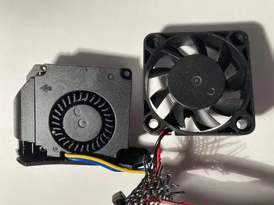

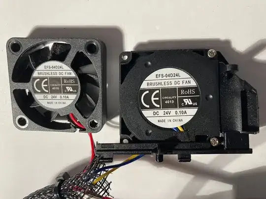

Both fans are listed as "brushless" EFS-04D24L; of course, they look different in the pictures below:
Fans label side
Fans back side
What options are there to help reduce the fan noise? I wasn't sure if a baffle or enclosure would help. Or would it be easier to replace the fans with quieter ones?

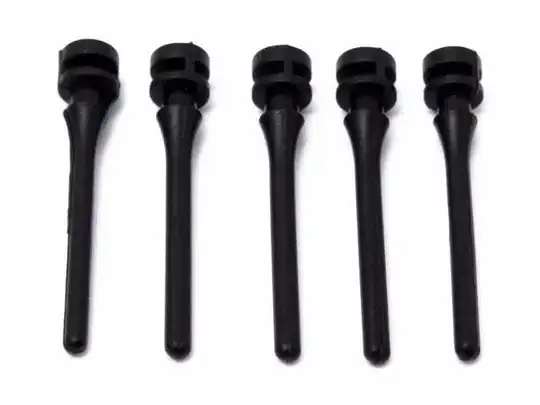

Mounting the fans using rubber anti-vibration standoffs/mounts2, instead of bolts, would also reduce vibration (and hence noise).
Rubber anti-vibration mounts
Or, failing that, if using bolts, at least use rubber washers/grommets, between the fan case and the frame/mount (maybe on both sides - frame side and bolt head side).
