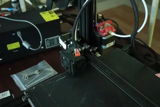

I have a used Creality CR-10S and I have been using it for one day. I seem to be having problems with my Y-axis. Several times when I selected "Auto home", the bed only moved part of the distance it should have for the head to get to the bottom left corner. It is only the bed movement that has the problem; the head successfully goes to the extreme left each time.
This picture shows an instance when the bed only moved half as far as it should.
It does not always happen and when it does, it seems to usually go half as far as it should, but once the bed did not move back at all. I am having a similar problem on "Bed Auto Leveling". Once when it was supposed to go to the back left corner, the nozzle went past the bed by about 5mm. I tried to reposition it with "Move axis" but it thinks it is at 0.00 and it won't let me go negative. One way I can fix it is to "Disable steppers" and then move the bed by hand.
I have done two prints and in both cases there was no Y-axis drift during the print. After first print, "Auto home" only went half way but I was not paying attention to other details. After the second print the machine was off and I moved the bed by hand in response to @octopus8. Then I turned it on and selected "Auto home". The head descended and moved all the way to the left but the Y-axis did not move at all.
When I move the bed by hand through its entire range, either with the machine off or after choosing "Disable steppers", it is pretty smooth. It has some resistance to movement, about the same as the X-axis resistance. I can feel very small "steps" if I move it very slowly. These are both consistent throughout its entire range. There are no individual spots where it behaves differently.
I have made sure that the bed's belt is tight. I check the wheels.under the bed. I cleaned them with a rag. When I turned them by hand, several were slipping against the rail (not causing the bed to move when I turned the wheel.) I tightened their bolts and that tightened some of them against the rail but a couple others still slip against the rail. Is this important? After these adjustments and turning printer on, "Auto home" worked and the steps on "Bed Auto Leveling" also did the correct things. I will report on more post-adjust experience as I get it.
Ever since I tightened the Y-axis belt and wheels I have not had the problem happen again having done 10+ prints. I tried the gcode that @octopus8 suggested at various speeds and the print head always ended up back where it started.
I will keep printing and if I experience the problem again I will investigate more then.
