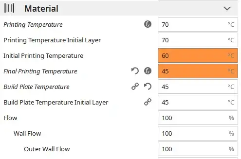

I'm using Cura to slice prints from a biodegradable polyester called PCL (Polycaprolactone).
I need to print @ ~70 °C but extruder does not run until nozzle reaches 175 °C.
Which setting to change so extruder will turn on when nozzle temperature has reached 70 °C?
Here are my settings for the material:
strong text
  • You do not need to use "starting" and "final" printing temperature, only "Printing Temperature" is needed. Can there be a minimum temperature at play here? E.g. usually there are cold extrusion prevention temperatures at play in he firmware, but that doesn't explain that the hot end heats up to 175 °C. Please add the first 30 or so G-code lines. – 0scar Jan 29 '21 at 14:34
  • Hi oscar, i suspect it is the cold extrusion protection. It is using Marlin. The extruder motor will not turn on until at least 175 °C. How do i disable the cold extrusion setting? Or change the minium temperature from Cura? Or doo i have to install firmware with editted configure? Appreciate it! – Jorge Mercent Jan 29 '21 at 14:43
  • So i looked through the g-code and added in M308 and M17 settings, still nothing. I really have no idea why the extruder is not being turned on. Is there a specific g-code to turn it on? In the code, the e axis is on though – Jorge Mercent Jan 29 '21 at 16:03
  • Please read the [answer](https://3dprinting.stackexchange.com/a/15497) below to disable it. Cold extrusion prevention was the first thing that came to mind. I wondered why the temperature reached over 170, but that was done by you apparently . – 0scar Jan 29 '21 at 22:05
