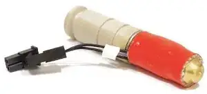

picture on the left
This hotend is made out of PEEK plastics (beige). It can work in temperature upto 250C. As it is also good heat insulator then it doesn't need to have cooling fan. Red part on this picture is just a cover (insulator) of the heater which heatup nozzle (gold). Black are just wires and connectors.
