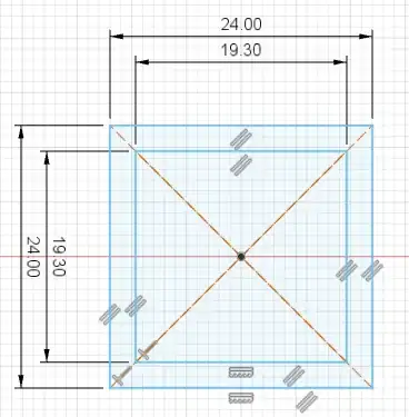

Here you can see test dimensions I modeled:
Test dimensions

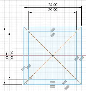

And it will come out with these dimensions:
Resulting dimensions

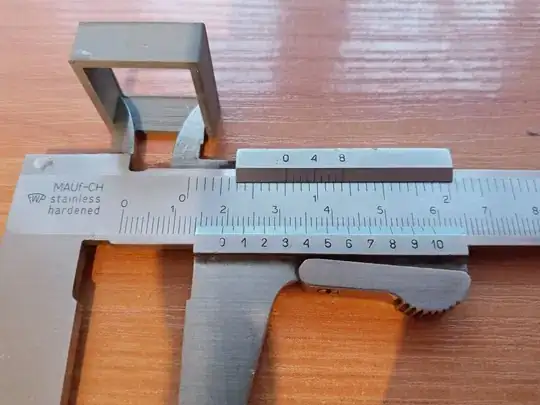

Aaand the final print looks like this:
Final print
As you can see, my estimation (second picture) was almost perfect. 19.3 mm and results are weirdly consistent. Always holes are 0.6 - 0.8 mm smaller than holes in model.

There are 3 effects at work, and you misread your micrometer: the measurement is 19.35 in the picture.
You have a little lip
There's a little lip at the top and bottom of the print. You'd need to clean that up with a sharp knife or sandpaper. That is the biggest part of the error you measure.

  • I read 19.3 mm from my micrometer, proper value (will not argue about 0.05 mm). On this side of 3D print there is no "elephant foot". I am still missing 0.7 mm (or 0.65 mm with your readings). – Jan Kowalski Jan 02 '21 at 12:35
  • So there is no little lip and I think that PLA does not shrink that much. 0.6 mm is a lot when working with holes as big as 5 mm for example. I guess my problem is "Movement errors accumulate". Is there a way to improve that? – Jan Kowalski Jan 02 '21 at 19:19
