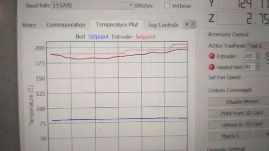

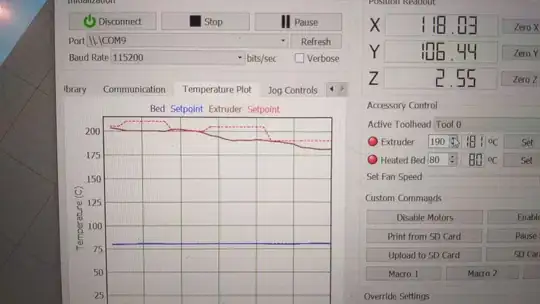

I managed to run it longer by repeatedly dropping the temperature set-point and making a photo of the temperature plot. First photo is right after the initial drop from 215 to 205 °C. Second is when the temperature started rising slowly again.
Right after the initial drop from 215 to 205 °C
Temperature starting to rise slowly
After this temperature drop, the hotend temperature seemed to be much less stable and reached only 205 °C.
At Layer 12, the same thing happened again. But dropping the temperature far too low for PETG and having the "same" issue again, making me stop the print.
This problem is pretty urgent and I haven't found any suitable solution by now. Do you have any ideas of what may cause this trouble? New heaters and thermistors are on their way right now. But I fear that this is not a hardware problem since none of the components are damaged and dysfunctional, nor the moment of failure is random.

    I started again, printing at 235°C. Before the print failed again, I recognized that the hotend never reached the setpoint. At first sight, I'd would guess that the P-Value of the Controller may be set wrong. But looking at the heater signal (led on the mainboard) tells me that it is on full blast. Maybe a damaged heater lacking power wasn't a bad Idea at all. If changing the heater is a solution for my problem, I'll let you know. – jwagn Dec 17 '20 at 14:35
  • can you show me a photo of the extruder? Possibly the airstream from the fan brushes over the heater block... – Trish Dec 17 '20 at 18:14
  • It's the stock Ender3 fan, i'm also certain, this wasn't the Problem at all – jwagn Dec 20 '20 at 14:19
It turned out, it was a faulty heater, that wasn't able to reach and maintain temperatures over 195 °C in a stable manner. The order came, had a new 50 W heater, thermistor and a PTFE-Bowden tube. It works just fine again, now!
