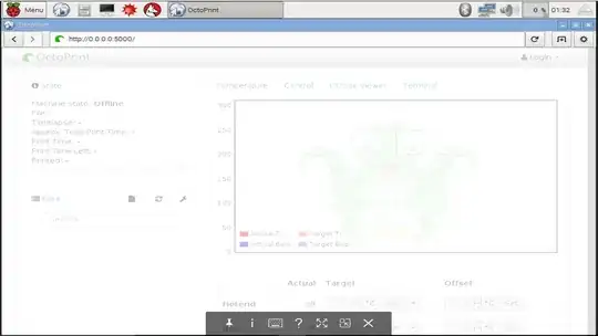

And then I start the octoprint server
 ~/OctoPrint/venv/bin/octoprint
The webpage of Octoprint freezes
I don't know if this is fixed in later commands, but I would like to get a sense of how all fits together before continue. It doesn't look that is the browser (I am capable to visit other websites without any problems), so is maybe Octoprint? How can I fix this? Did anyone have this problem before? Thanks in advance

  • Do any errors pop up in the console? Press F12 and go to a console tab/menu, paste any errors you see. There might be an issue connecting to a machine. Do you have the machine turned on? – tbm0115 Jul 11 '16 at 02:26
  • I just added the output in the console. The raspberry pi is turned on. Also I forgot to say that the website is fine when is loading, but after 3 or 4 seconds, it freezes – Dauph Jul 11 '16 at 03:15
