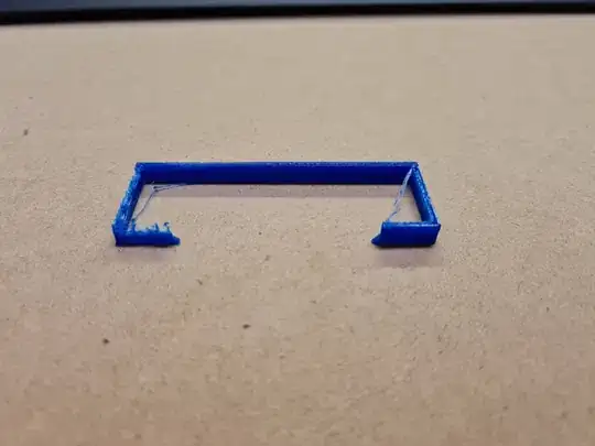

Trying to print a bracket for pliers, however the support material on the left side always fails by under extruding. The model is left-right symetrical, so the support is the same for both sides. However, only the right side prints flawlessly, while the left side barely extrudes any material at all. So far, I have tried increasing the extrusion multiplier to 125% (from default 109% - actually resulted in less support printed on left side), increasing the density of the support material and reducing retraction distance while increasing the retraction speed. I cannot get the left side support to print properly. The actual model prints without any issue, only the support material is failing to print. I am using a Flashforge Creator Pro and Flashprint slicer software.

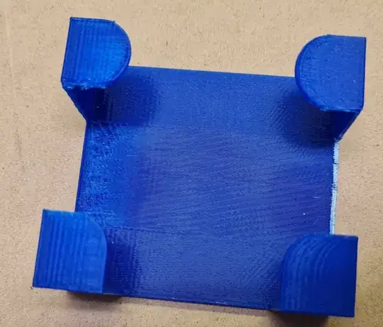

I allowed one of the prints to finish, pausing numerous times to add/adjust some tape to the almost non-existent left support structure to help hold it together. Once it reached the top part of the model where it printed the overhanging portion, it printed near-perfect, with some minor under-extrusion along the way (as seen in the first image)

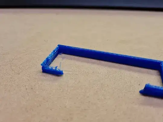

I can't remember the exact settings used for each attempt, but I can recall (mostly) the settings I adjusted Default extrusion multiplier (109%) ^^ Default extrusion multiplier (109%)

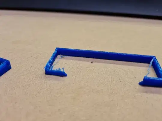

116% extrusion multiplier ^^ 116% extrusion multiplier (little perceivable difference to default)
