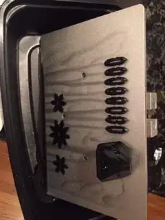

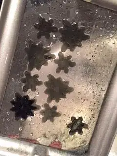

In a print composed of three rows of parts, the center row is sticking to the bottom of the resin tray instead of the the print plate. I have tried the print five times with similar results.
These pictures include the best and worst results:
best case: most of print on plate worst case: most of print on FEP sheet
Any ideas as to cause? Should I clean the transparent sheet at the bottom of the resin tray in any special way?

  • Left is a plate (best), right is the worst (FEP sheet). It is pretty clear when you think about it. And the additional info was in comments as the intent was making it part of the answer, not of the question. – 0xF2 Sep 10 '21 at 15:41
In my experience, when I had the same issue happening it was because my first layers exposure time what too short.
I was experimenting with bottom exposure time (in order to reduce the elephant foot) and sometimes, with very low exposure's time, I had failed prints that didn't even adhere to the print plate and remained stuck to the FEP (exactly as it happened to you).
Try increasing the bottom exposure time and check the exposure times your resin's manufacturer is providing.
