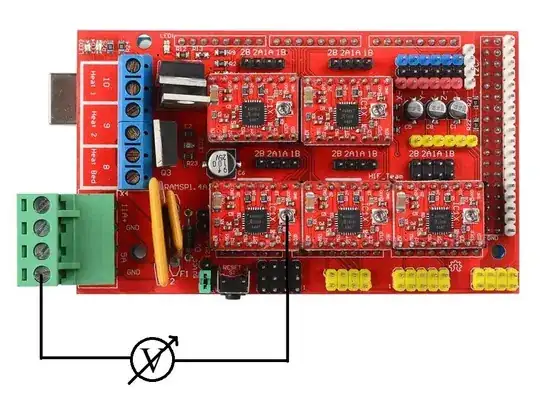

  2. Connect one lead of your multimeter to the ground of your Prusa i3 controller board's power input (I use the screw that fastens the ground input of the RAMPS). The other lead goes directly to the center of the trimpot on the Stepstick. I took the best of my paint skills to create an image showing the process: measure Vref scheme
  3. Note the value you read (12V power has to be on)
  4. Use an insulated screwdriver and turn the trimpot slightly.
  5. Get a new reading by repeating the measurement process.
  6. Repeat the whole process until you get the desired Vref.

Getting back to your question. You have to know what is your stepstick reference voltage. To make sure about that you have to check out resistor(s) next to main black element on stepstick board. There should be R100 or R200 which are very common.
Now you should read data from motor label to know what is proper current for your motor and calculate
voltage = motor_current * 8 * resistance_of_resistor
So now you know what is proper voltage for your motor and stepstick.
You measure voltage between potentiometer and GND (see on the picture)
