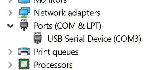

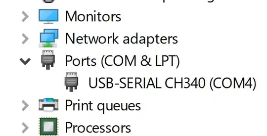

I also think that its worth mentioning that my bricked board and new board seem to appear differently in the device manager
Bricked:
While my new board appears as this:
The new board also seems to "cut-out" when I first connect it to my computer as well. In the device manager, my computer will indicate that an unknown device is connected, then it will quickly disconnect and disappear, only to reconnect and reappear as pictured above.

Your new board may have a counterfeit FT232R USB-to-serial interface chip, and the Windows update channel has installed hobbled FTDI drivers that won't work with counterfeit chips. The use of counterfeit FT232R chips is very common with budget 3D printer controllers, and FTDI are trying to discourage their use. Because of this, a lot of manufacturers have switched to using the CH340 chip, which does not suffer from this problem, and it looks like your old board used a CH340 chip. Try deleting the device and its drivers, and then installing the Windows setup executable from the following website:
https://www.ftdichip.com/Drivers/VCP.htm
The 2.12.28 drivers will work with counterfeit chips.
