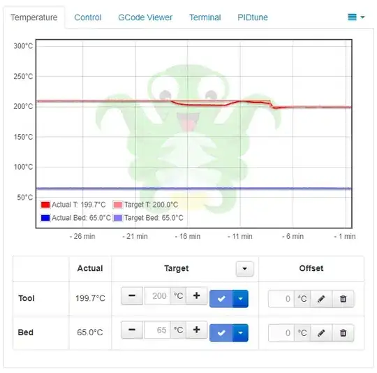

I'm printing basically a large flat square pane. This goes fine for 3 layers, after which the temperature suddenly drops by about ten degrees. After a while, my printer goes into thermal runaway protection.
I restarted my print, and as soon as the temperature drops, I pause the print. I wait for it to go up again, and resume. It starts dropping again, so I decide to see about continuing this part at 200 degrees (which worked quite fine, so I think I'll stick at 200 for now.)
Temperature suddenly drops to 200
I have tested running the printer at 210 and turning on the fan, thinking maybe it's simply related to that. That does not give a thermal runaway, and a drop of 2 degrees max. My assumption is that it's the PID.
How do I fix this?
My printer is a heavily modified Anet a8, running Marlin.

  • @R..GitHubSTOPHELPINGICE Yes. The problematic drop is the one around -18 min, not the one around -8 min. The one around -8 min (the drop in target) was manual. And I'd assume that any conceivable temperature reduction command would show up in the light red line, right? – Daniël van den Berg Oct 29 '20 at 20:33
