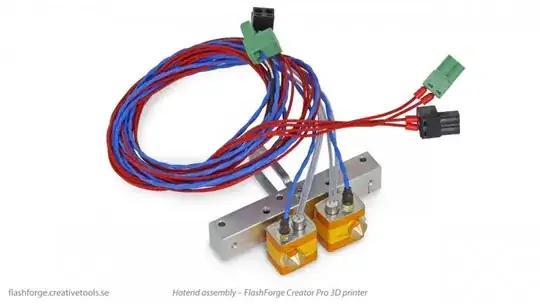

The FlashForge Creator Pro uses a MK10 hotend:
The Micro Swiss MK10 All Metal Hotend Kit for instance is reported to be a drop-in replacement for the FlashForge Creator Pro, it uses M7 threads.

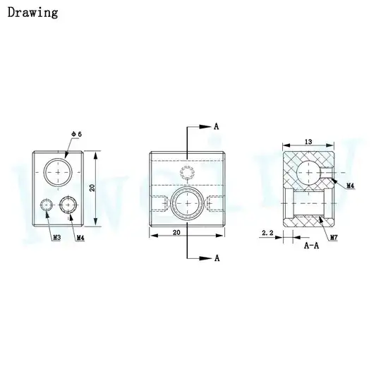

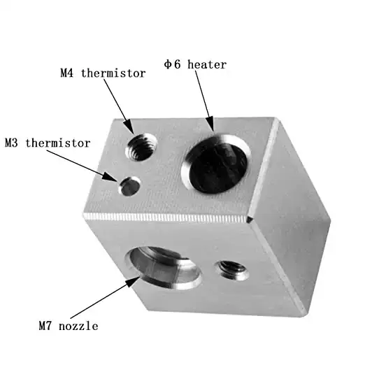

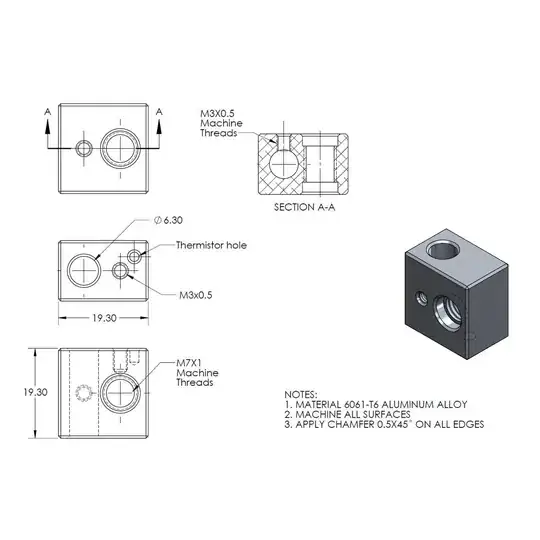

The heater block for an MK10 has a threaded hole for the thermistor (M4), but some use a machined hole for PT100/3 mm thermistor cartridges. The block measures around 20 x 20 13 mm. The images below should give you enough information to create your custom blocks. However, there appear to be 3rd supplier after-market blocks available on on-line webshops and market places
The Flashforge original spare part heater blocks show that they are slightly different (the top image shows symmetrical heater blocks while the spare parts are not symmetrical), so above drawings and caliper measurements should give you enough information to reproduce the heater block.
