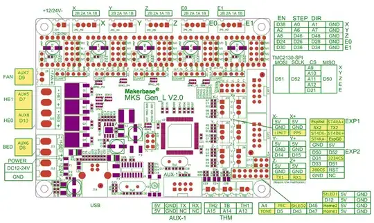

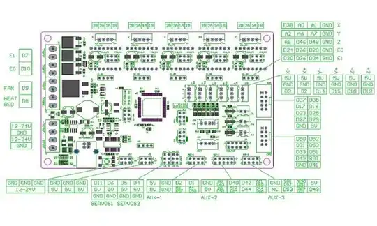

The MKS GEN L v2.0 lacks the AUX-2 port that is present on the v1.0 controller boards. The reason for this is that they implemented support for more modern stepper drivers like the trinamic drivers that are capable of using UART to set stepper options.
The old v1.0 pin layout is displayed below: MKS GEN L v1.0 pin layout
The new v2.0 pin layout is dislayed below: MKS GEN L v2.0 pin layout
The Anet A8 2004 graphical display (so-called ZONESTAR_LCD) uses (at least one as the buttons are suited with different resistors) analog pin that is used to detect which buttons are pushed.

In order for this to work on the MKS GEN L v2.0, you need to source for free pins that can mimic these pins and alter the header file and create a spliced LCD cable.
It might be much easier to buy a new reprap discount display controller for about 10 bucks/euros and connect it to the dedicated EXP1/2 headers. Stay away from the Anet A6 graphical display.
