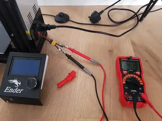

Some investigation revealed that the glass fuse in the PSU power connection was blown. I've replaced that and also ordered a replacement PSU, but the printer still won't turn on. The PSU is outputting 24 V, I've tested that with a multimeter and attached a picture.
I'd be very grateful for any further hints as far as debugging this issue goes. I feel like the next step might be buying a new mainboard and testing with that, but I want to make sure I'm not missing anything obvious.
