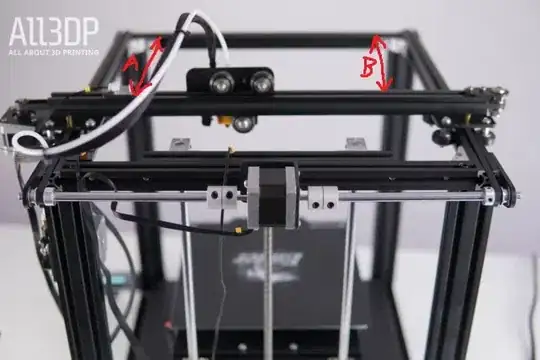

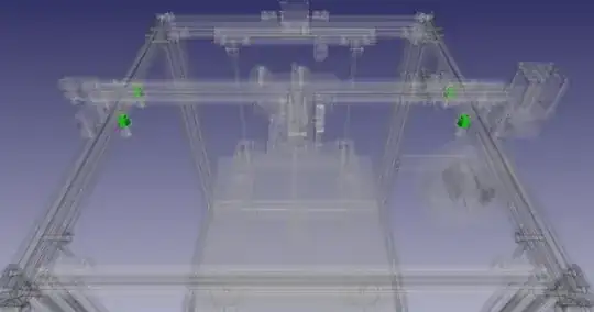

How would one go about squaring the gantry relative to the frame?
Referring to the image below, distance A and distance B are not equal.
Also would this account for the reason why when I attempt to print a circle it is not perfectly circular, and when I try to print a square, it is tilted?

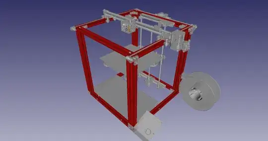

  1. Make sure your frame is square: Frame If it's not square, try to loosen all the screws (don't forget about those holding the motherboard) and tighten everything again. Use a level and a carpenter's square.

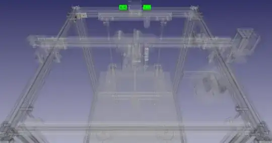

  2. Loosen the shaft couplings on the Y axis. Those: Shaft couplers

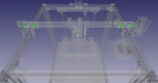

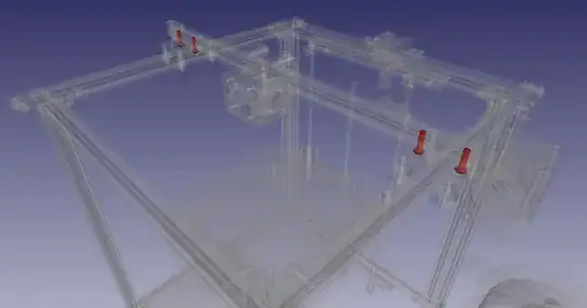

  3. Loosen these four screws: Gantry screws

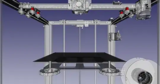

  4. Loosen these eccentric nuts: Eccentric nuts

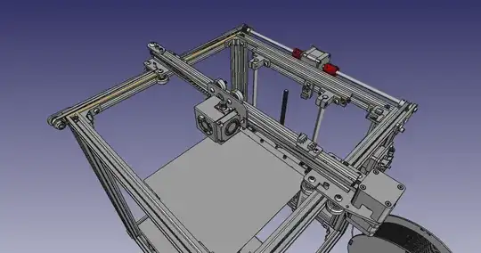

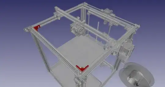

  6. Move the gantry to the front side of the printer so that the wheels touch these corners: Aluminum corners If your frame is square, it would mean that X and Y axes would be perpendicular to each other.
