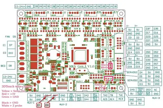

My servo pin is connected to D11 and my two wire pin is connected to the ZMAX endstop. Here is a diagram:
3DTouch Wiring

Ok so I did a bit of testing with the wiring and it turns out I just had the 3DTouch in the Z- socket instead of Z+ :-) . Another idiot mistake from me!
