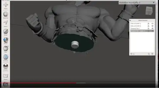

With so many questions, I'll provide a suggestion for your first one, the alignment option. There's a 12 minute YouTube video showing how to use Meshmixer (free, multi-platform) to create alignment pins and holes while segmenting a model for printing large items.
Meshmixer screen capture
The process involves making the cut, keeping both sections. A pin is created and sized, then placed in one of the faces, while the other segment visibility is turned off. The pin is then triplicated, with one pin moved away for printing.
One of the two remaining pins (overlapped) is selected and is used for a Boolean subtract operation, creating a hole that is matching in size and location.
The first segment visibility is turned off, the second segment is turned on and the pin is selected again. The sequence is duplicated, creating a second, matching hole.
I didn't watch the entire video, but if it is not suggested, one should reduce the third pin size, at least the diameter, sufficiently to allow it to fit the holes created by the above process.
Note that the video has some inconsistencies from my experience. Some terms are changed from the video to the program, but should not cause problems.
  • Thank you so much for your answer. I've already published the shrinking part into another question to keep it clearer (see edit). And that's more or less what I was looking for. **I guess that the short answer is that is not possible to make parts that are very precise in terms of joints, as you run the risk of making unable to snap at all?** – Unapedra Aug 19 '20 at 11:28
    If you use a Square or hexagonal pin instead of a round one, the method described also makes the pin work as a quite effective alignment tool. Another option would be to use 2 pins. I suggest to scale the "peg" down about 0.3 mm in diameter for FDM, but on an SLA/DLP you might get away with a 0.1 mm thinner one. – Trish Aug 19 '20 at 16:50
    The video does suggest a square or non-cylindrical peg and I've used a pair, well, a pair of pairs to ensure alignment. – fred_dot_u Aug 19 '20 at 17:36
  • Ok! I see! Yes, it seems that the square is best if you don't want the pieces to move, because even if it's shrinked or smaller (or not very precise with the joints), it will prevent it from rotating because of its squared shape. That's a good thing to know! – Unapedra Aug 19 '20 at 20:41
