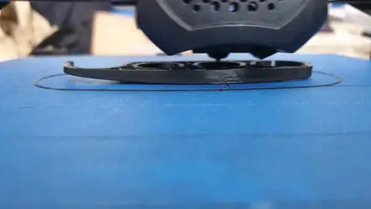

I've had all sorts of trouble getting first layer to stick but finally managed it. However the thin end of this hook has now warped and the other end is too.
Photo showing warped hook (left hand side)
Looking at the image above, you can see it's much thinner at that end. Should I try a lower nozzle temperature? Or bed? Or both?

I have to mention that the tape has been cleaned with isopropyl alcohol. I can print PLA no problem direct to the bed but am having so much trouble with PETG - rather than warping this could actually be adhesion problems. I've tried a higher initial layer (0.3 mm vs 0.2 mm), 0.1 mm Z offset, gapped to 1 sheet of paper as per PLA, then 2 sheets - I've done that 50 mm in on each corner and then checked it in the middle of the bed too. Initial layer is at 10 mm/s and then to 40 mm/s
As you can see in the picture the brim looks rather flattened, but if I give more gap (e.g. 3 sheets) it doesn't even stick at all.

Try printing with a brim (I believe what you used in the picture is a skirt; you want the one that is attached to the part) and start with no cooling. Ramp up cooling to the minimum you need for good print quality.
