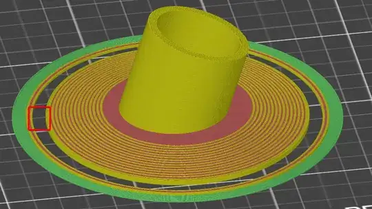

I have a repair part that I need to print with ABS and I know that I have warping problems with ABS.
I'm now trying to mitigate this by printing a circle around my object and use more brim. You can consider this as a manually designed skirt, but I want the brim to be on both sides of the skirt.
However, when slicing the repair part with the ring, I get brim only outside the "skirt", not inside of it. How would I get brim also in the area marked here?
Add brim here

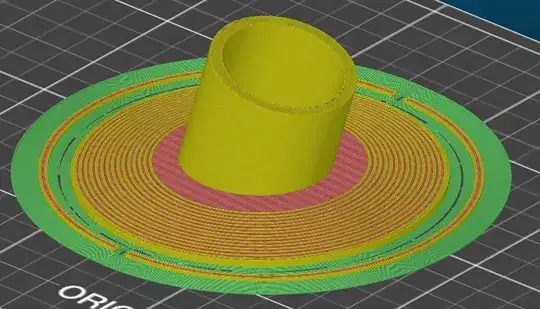

When there's a cut in the outer ring (the manual skirt), Slic3r will fill the area as expected:
Brim in the gap
Thomas Weller
  • 781
Prusa Slicer 2.2.0 in print settings skirt and brim, set distance from object to zero
Other slicers should have same capability. As long as you have two parts on the bed that are not distinctly separated, you'll get only one brim.
