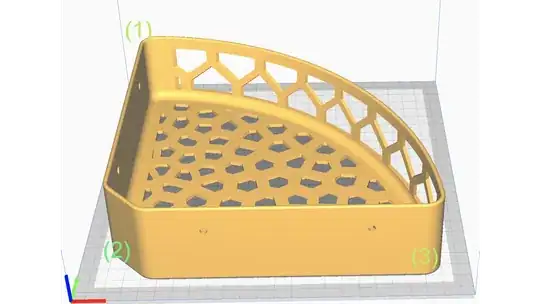

I have a model that's placed on the bed exactly like on this picture:
sample model placement

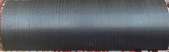

I have constant quality degradation as the bed moves down to print in the upper left corner (1).
Everything is fine on the X (2)-(3) side. It does not have any visible artifacts. All hell goes along the (1)-(3) curve:
hell lines

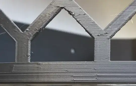

Top left corner (1):
top left corner
On the way from (1) to (2) lines seem to disappear almost completely.

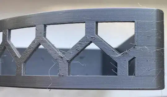

Corners have become much sharper and there is a lot less of bulging on the arc.
arc

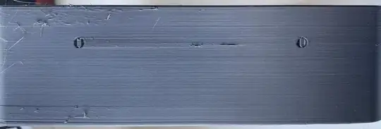

However, by X-axis (2) - (3) I see more artifacts:
x-axis bottom

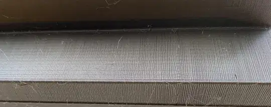

Y-axis has become better:
y-axis bottom

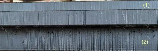

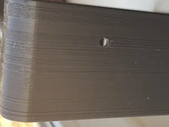

I've made belts a little bit tighter and decided to print a new model. The layer height is 0.3 mm. Also, I tried increasing temperature up to 240 °C and changed the stock vent with a circular vent. The wall count is 50 to make the model solid. Coasting is off.
x-axis
x-axis curve

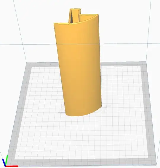

Now all artifacts are along the X-axis. There are many fewer of them at (1) than at (2). The model is a doorstep. On the build plate it's placed like this:
doorstep build plate placement
Now I think the problem has nothing to do with X/Y play and these two factors can be eliminated. I'll revert belt tensions back to their previous values and decrease the printing temperature down to 225-230 °C.

I have finally figured out what was wrong. It was insufficient Z-belt tension on both sides. A close look at a DSLR camera shot gave me a clue: there was almost always a straight segment followed by a visible additional step down between layers.
There are still some artifacts but everything looks relatively tolerable now.
after z-axis has been fixed

There are a lot of different print quality problems going on here, but the biggest I see is the bulging and sagging at the corners of each layer. This is a result of extrusion not being a zero-delay linear function of extruder motor motion, but subject to compression/pressure. This causes excess extrusion when printing slows down (approaching and rounding a corner) and underextrusion just after speeding back up. There are several possible fixes:
  • Upgrade to firmware with Linear Advance and calibrate it for your material. I find PETG needs about K=1.4 on an Ender 3.
  • Increase your acceleration limits (up to 3000 mm/s² should be ok for Ender 3) so that far less time is spent moving slow. You need to adjust the per-axis limits in config menu, not just the single acceleration setting in your slicer.
  • Decrease your print speed so that there's less difference in cornering speed and nominal speed (50 mm/s is too high for PETG anyway in my experience; you'll get underextrusion and bad layer bonding).
Also make sure you don't have your slicer set to slowdown on overhangs, as it makes this phenomenon far worse.
