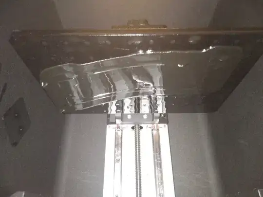

I have been having a mostly successful print, at good quality, but the bed adhesion keeps haunting me. The best print on this machine had parts curling up from the build plate, however most of the print succeeded.
  • Two times I have had a very well adhering raft, however delamination occured directly after the raft.
  • Usually the left side lifts from the bed while the model stays on the build plate.

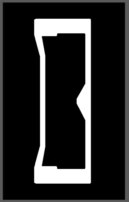

first layer with small raft

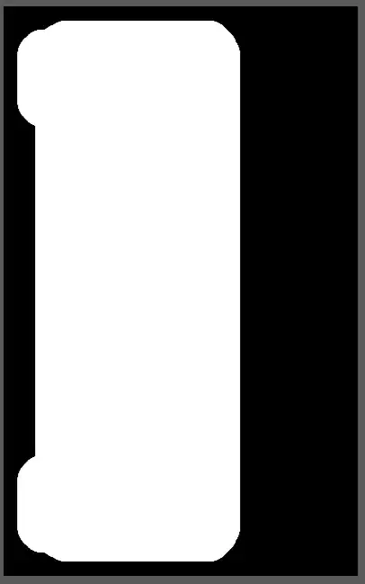

first layer with large raft model peeling off of print bed
