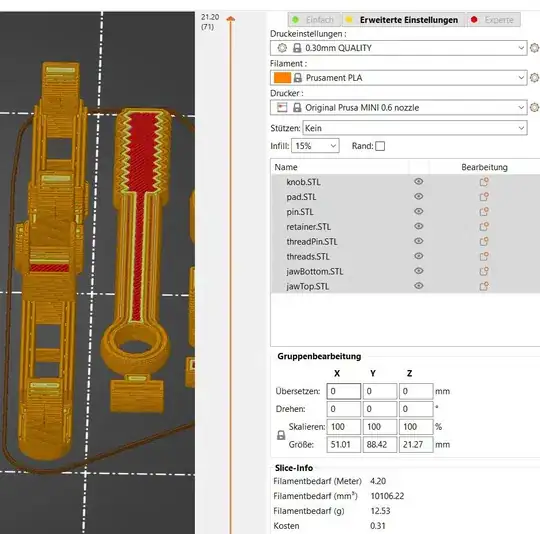

  • Find the G-code here
  • The amf is found here

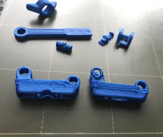

After I switched to the 0.6 mm Nozzle I have massive problems to get good results, as you can see in the picture below. The two parts in the front starting to have from the height of about 5 mm very bad lines. I realized it 5 mm later and I set manually the temperature from 215 to 220 °C which seemed to solved the problem a little bit, but still not perfect results.

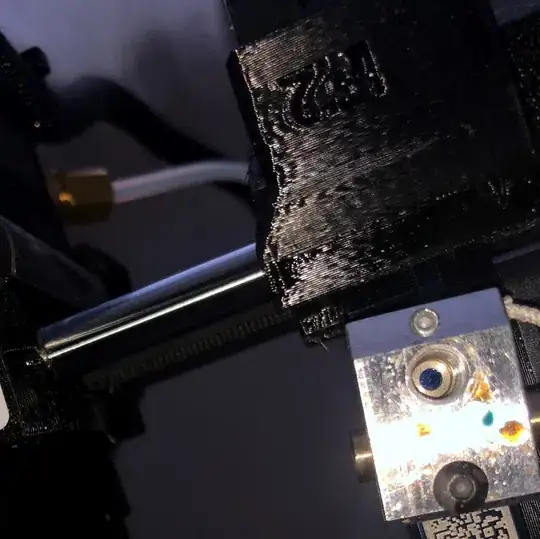

As you can see in the second picture, I removed the 0.6 mm nozzle to make sure it fitted. I did, there is no filament on the thread.
Test: I did use some noname filament with the 0.6 mm nozzle first and had bad results as well. The problem mainly was, that the temperature (215 °C) was too low. So I raised it for the noname filament to 240 ° which seemed to solve the problem but quality was not perfect, so I switched to the Prusa Polymers filament to make sure the issue is not related to the filament.
So what could be the issue here?
