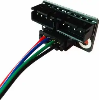

No worries if the board doesn't have two Z stepper connectors, you can buy dual stepper breakout boards, e.g. a parallel solution:
Dual Z stepper connector breakout board

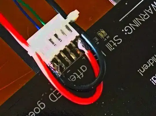

Anet heatbed
The Anet heatbed is notoriously known for fire accidents/burning caused by the underrated connectors (the connector itself is not rated for 10 A!), also the connector should require proper strain relief. The best solution is to solder the heat bed wires directly to the backside of the connector (which is what I did on my old Anet A8 printer, I used multiple pins soldered together, both the outer 2 pins on either side), an example from the web (downside is that they only used a single pin) shows this principle (with solution for cable/soldering stress relief using a tie-wrap):
Anet heatbed soldered to the back of the connector
A final notice for connecting heatbeds is to use proper cables; silicone cables of proper gauge (silicone wires are very flexible, e.g. AWG 14) should be used. Also, never solder the ends and put them under screw connectors on the printer board, instead, use ferrules or proper sized fork terminal connectors.
