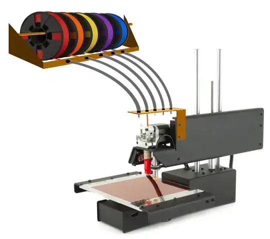

I'm setting up my printer in a small room, and I thought I'd come up with a system for more easily swapping filaments, but I'm not yet sure it is feasible.
Rather than physically replace the spool, I'd like to hang most of my spools on the wall, where they can rotate, and only swap filament leads in the (direct drive) extruder. The spools would be placed at some distance from the extruder, and at various angles. So to make sure the filament is pulled from the spool at the proper angle, and to avoid breaking it, I think it should probably run through a flexible tube to reach the printer.
I know such tubes are used for Bowden style extruders, but what I'm proposing is different in at least two ways: [1] the extruder motor would be pulling (not pushing) filament through the tube and [2] the tube would be longer than normal, e.g., between 1 and 2 meters.
Is this plan feasible? Or are the problems I am not foreseeing?

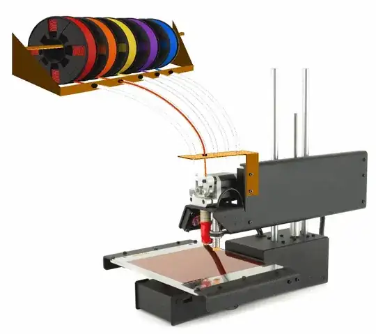

Edit 2: To clarify my proposed setup, here's a crude mockup:
mockup
mhelvens

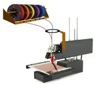

In the situation you've described I would rather install some kind of vertical ring a bit above your printer. This ring would organize your filament going from any direction.
So let's assume you got one spool on the right and one on the left of your printer, both are 1m away from the printer itself. If you get filament and put throught the ring then to your extruder.
In my opinion the ring should be around 15..20cm over the printer, it should have around 10..15cm diameter and spools should not be too low.
The only issue I see is unwinding spools which are too far from the printer because then filament would be unwinded angular but the same issue would be with and without teflon tube.
[edit] Here is a simple change of your design
[edit2] Please also note that you can assure proper angle of unwinding filament by installing small rings ("eyes") next to spools. These eyes will direct filament out of spool and then filament will turn to your big ring mounted on the printer. This is common solution in textile industry

  • I'm not sure I understand your proposed setup with the ring. Would it be too much trouble to ask for a quick mockup image (like the one I added to the question)? – mhelvens Jun 13 '16 at 18:22
  • And the issue of pulling filament at an angle (and expecting the spool to keep up) is the reason I'm suggesting tubes. If the filament angle is properly guided at the source, I don't see that as a problem. Thoughts? – mhelvens Jun 13 '16 at 18:30
  • @mhelvens please take a look on my post (edit). Please also note that rings can be used on both sides of the design (Thanx Tormod). You can apply little "eye" next to the spool which will assure the filament is unwinded at proper angle, then there could be a loooong way to the ring proposed by me :) (of course on that way there could be even more rings which will direct filament properly)... assuming you are pulling, which you do – darth pixel Jun 14 '16 at 04:55

Update Based on the OP's drawing, I think it would benefit to change the design to drop the tubes all together. The tubes can provide many point of contact and managing so many lines at once may become problematic. So, possibly drop the tubes and intend on not drawing your filament unless they are fed into the extruder. You could install smaller ends of tubes at either end of assembly (one at the storage rack, the other above the extruder) to ensure the filament is being fed/pulled straight. The space between the storage rack and the machine doesn't matter. Here's a basic edit of your design that might be easier to manage. For kicks, here's a design I made for my own machine as a "quick-change" design.

  • Thank you for uploading your sketch, it helped understand more of what you're trying to achieve! +1 – tbm0115 Jun 13 '16 at 19:44

Yes, this is feasible. You should constrain the tube at both ends, this prevents the spool from pulling up on the extruder. This approach is known as reverse bowden setup.

  • What do you mean by 'constrain the tube at both ends'? Are you simply suggesting that neither end should hang loose? Please have a quick look at the image I added to the question, to see if it matches your meaning. – mhelvens Jun 13 '16 at 18:23
  • Yes, this matches what I mean. Without the tube, the force required to get the spools to unwind is transferred to the extruder (possibly moving it around and decreasing print quality). With the tube in place, that force is instead applied to the mount of the tube. – Tom van der Zanden Jun 14 '16 at 14:05
This shouldn't be too much of an issue, as long as:
  1. You guide the filament properly to avoid breakage (at both ends as Tom mentions)
  2. You avoid too much friction between the pulling extruder motor and the spool itself.
You mention that you consider using a 1-2 meter teflon tube to guide the filament. Although this might work, long teflon tubes will increase the friction from pulling the filament. Furthermore, I really doubt having such a long tube will be beneficial at all; quite on the contrary, I think it could be rather impractical. Most likely, having simple guides at both ends (whether its tube stubs or rings) will suffice.

  • Aha. Guides at both ends, rather than a tube all the way. I can see the sense in that. Now that I think about it, other answers (like darth pixel's) may also have hinted at this. – mhelvens Jun 13 '16 at 18:28
  • @mhelvens, I believe that both Tom and Darth hinted at this. Whether it's a tube or rings probably doesn't really matter that much. :-) – Tormod Haugene Jun 13 '16 at 19:51
    @TormodHaugene Actually, tube v.s. rings makes a difference. A tube has the advantage I mentioned in my answer, rings don't. – Tom van der Zanden Jun 15 '16 at 10:32
