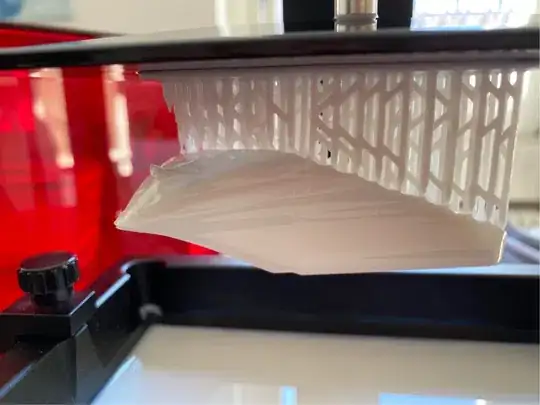

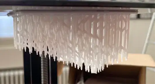

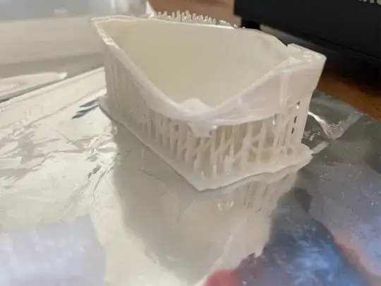

First failed print with 8 seconds exposure: the film was completely jammed and all the resin was stuck there (this is why there is no piece on top of the supporting material) First failed print
Second failed print with 6 seconds exposure: the film was perfectly clean, but the object did not stick to the supporting materials therefore collapsing. Second failed print pic1 Second failed print pic2

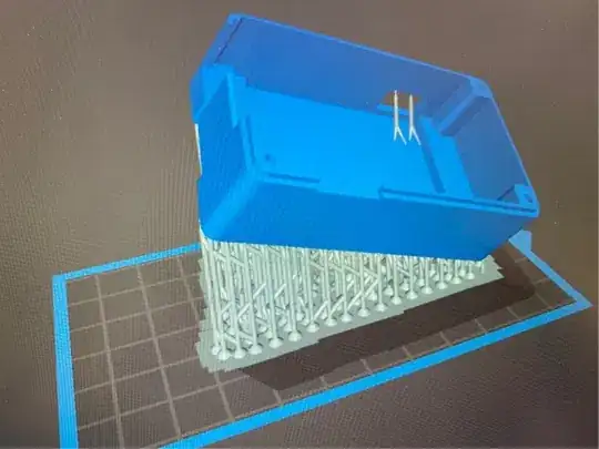

This is the 3D drawing 3D drawing

I have tried to print the piece upside-down with the cave part facing down and it worked. Since the printer prints upside down, positioning the cave part facing up creates a suction-cup effect on the printer display that makes the whole structure stick to the lcd and detach from the supporting structure, thus making the print fail.
