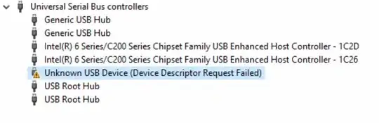

I want to use my secondary Win 10 PC for OctoPrint (Direct connection to the Printer via USB) but Windows detects the Printer as "Unknown USB Device (Device Descriptor Request Failed)" Im 99.9 % sure the cable is not the problem cause it works perfectly fine on any other device. I've tried installing multiple driver versions (including the one that came with the printer) but no luck yet. I also tried different cables/USB ports, no luck either.
https://imgur.com/a/H6IKAXM (Device Manager)
https://imgur.com/a/tqwqDMO (Properties)

I use linux, so I am not familiar with Win10 stuff. But, it seems that the device driver has asked the USB device for its identifying codes (PID and VID) and got no recognisable response. Could be a bad cable, but you seem to have checked that. Could be a fried USB interface chip, so check whether you have any luck trying to connect to any other computer. If you can find someone with a linux machine (or you have something you can run linux on), the logs will tell you a lot more about what has been tried and what failed (or not).
Note that the parent USB device is VID=8087 (being Intel Corp.) and PID=0024 (being the Integrated Rate Matching Hub) - see https://devicehunt.com/search/type/usb/vendor/8087/device/0024.
  • So apparently Windows is the problem. My printer is recognized as "ttyUSB0" on Ubuntu 18.04. From now I will only talk about Ubuntu. Now the problem is that I cant connect to the serial port. Every time I try to connect i only get sth like "Permission denied - Line in use". Same results with Root user or sudo – Daniel2193 Feb 02 '20 at 16:10
