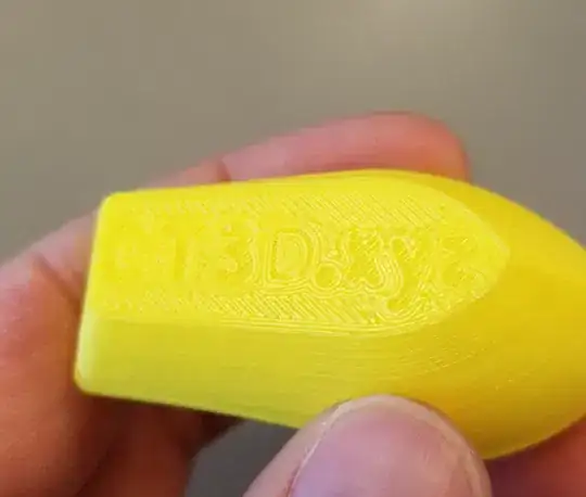

Thus the problem; the zeroing procedure has a minimum adjustment of 0.1mm. Getting the clearance just right for a solid first layer requires at least another order of magnitude finer adjustment. For now, I have it "good enough" to stick the first layer onto the plate, but the resulting prints show pretty classic plate clearance issues:
You can see the lines of the bottom layer aren't connecting horizontally, and the extrusions are thin and tubular, which are the textbook symptoms of excessive build plate clearance (not enough "squish" of the filament between extruder and plate). It's close, but this is a game of just tens of microns, and the printer simply does not give me that level of control; one more step down at 0.1mm and I hit the plate. The manual says you can babystep the Z offset at 0.04mm while actually running a print, but I have run several (including the leveling test GCode included on the printer's SD card) and have never seen that option enabled in the leveling menu.
