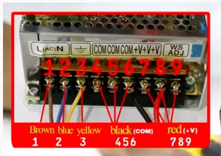

I tested the voltage of the power supply whilst it was turned on across connections 6 and 8 in the video below (taken from the assembly instructions video, 12 mins 46 seconds):
Assembly Instructions Video, 12:46
The 6 and 8 connections correspond to the output from the transformer (ie the connections that would be connected to the mainboard). There was no voltage reading at all when I measured it here with the multimeter. Does this indicate that there is a problem with the transformer/power supply, or is this expected? Or am I testing in the wrong place and there is a better place to test when the printer is on to determine what the problem might be?

If you look at the connection terminals you will find labels above them. Measuring position 6 and 8 might be the incorrect ones, this depends on your PSU. If you have exactly the same PSU as from the linked video, measuring between 6 and 8 would be correct:
From the image above the connections from left to right (for other PSU units, the order may be different, I have units where the connection to the mains is on the right):
  • L, N and ground are used for connection to the mains,
  • COM (stands for common or 0 V) or sometimes denoted as -V is the output ground (negative, connection for the black wires) and
  • +V is positive, connection for the red wires.
You need to measure the voltage difference over COM and +V, this should be the voltage of the power supply. Ideally you measure the voltage when the power supply is delivering a load (e.g. directly connected to a strip of LEDs or directly connected to the heated bed; some faulty PSU crash in under load, this can be seen by a lower voltage than the rated voltage).
If the PSU is correctly wired, your fuse is not broken, does not have a LED lighted and the voltage is zero the unit is defective.
