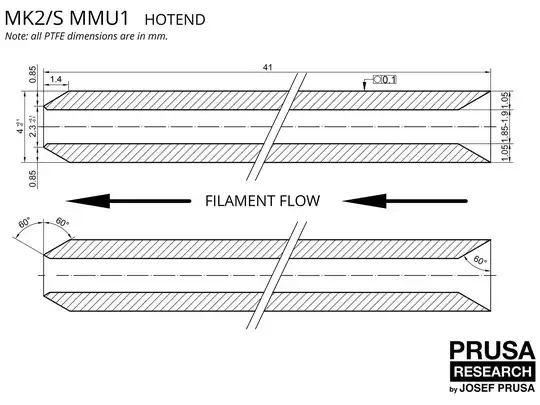

Filament sometimes get stuck on the rim of the PTFE tubes inside the heat sink. Josef Prusa from Prusa Research has published a document on how you should chamfer the PTFE tubes for his printers:
Maybe chamfering your tubes works for you too.

Thank you everyone for your help. Sorry I took so long to respond. I didn't get a notification of your responses. I'd like to to try this chamfer of the ptfe tube but this seems like a difficult thing to pull off accurately with a tiny round tube. Do you think a pencil sharpener would work? – Hellrazor Jan 20 '20 at 15:46
@Hellrazor You can find printed objects on Thingiverse, if you are still able to print small parts; e.g. [this](https://www.thingiverse.com/thing:3121653). – 0scar Jan 20 '20 at 17:46
